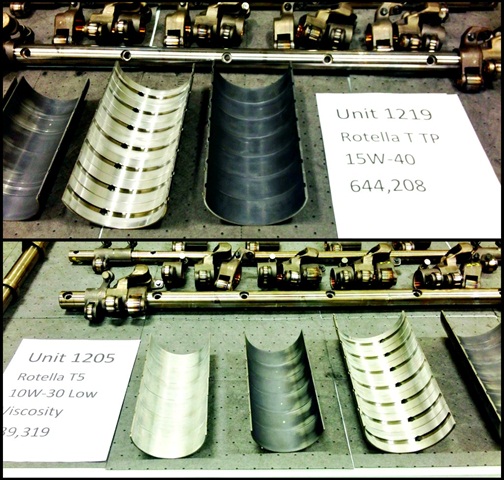

As a bonus, see the picture of Shell Rotella in action
