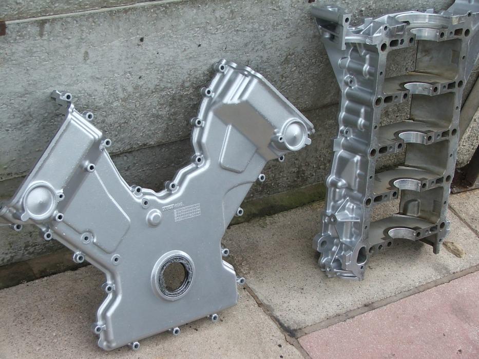

I was under the assumption any will do the job. As far as a threaded bolt hole goes put a bolt in and cut it flush? is it the same as this one? (2002)
Mine looks exactly like your picture. I've come across a few labeled '98 and they are missing the freeze plugs and have a threaded post on the passenger side arm. It's out in the middle of the arm just a little top side of middle. It would have to be an attachment for some kind of pulley as its right in the middle of the serpentine belt path. My idler pulley is in close proximity but it attaches in a different location.

yep, you need an AJ27 one instead of the AJ26.
