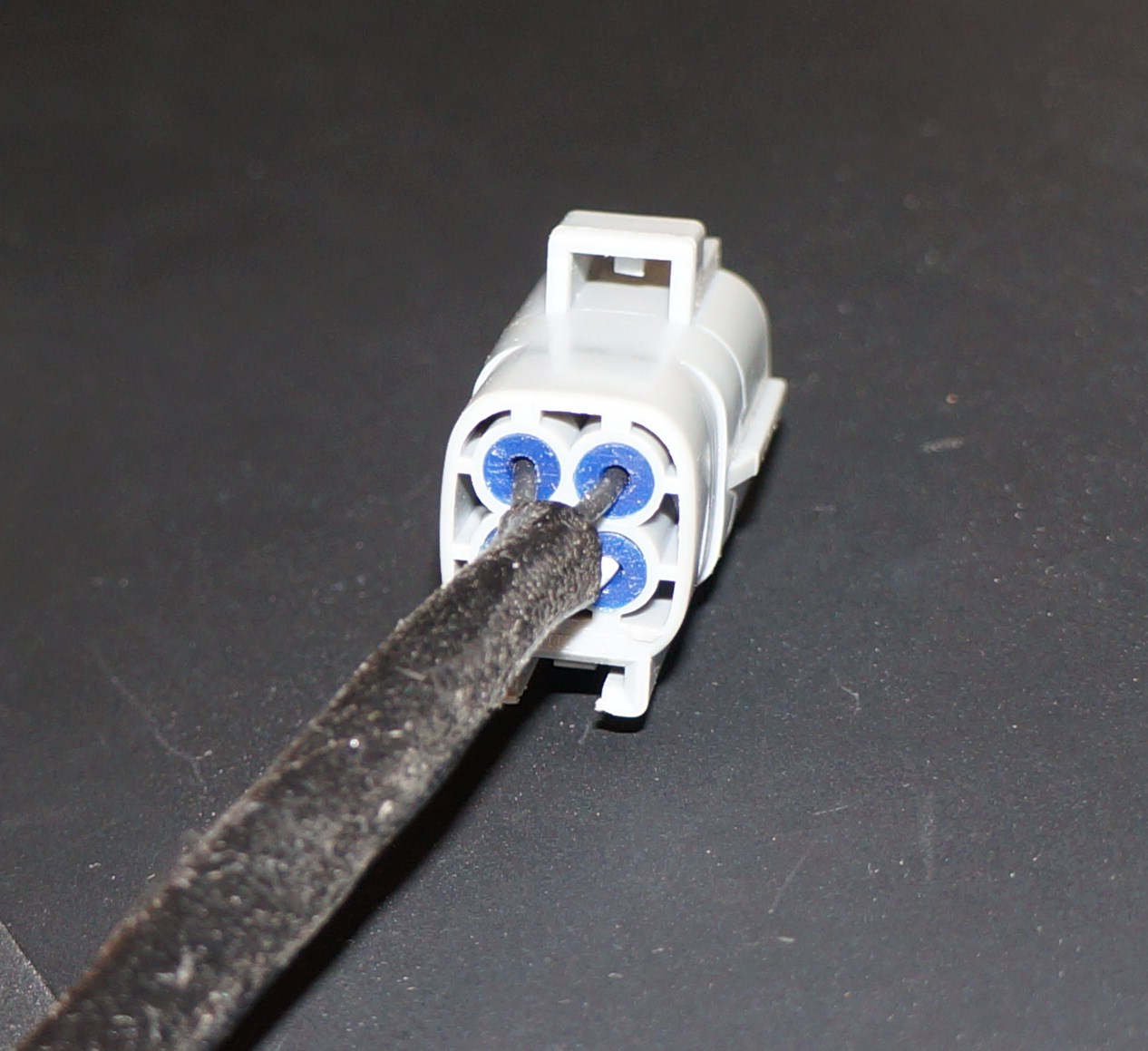

Thanks for the advice, but what part are you calling "the bench"?
The bench
Attached Thumbnails Oxygen sensor plastic connectors-o2-sensor-connector.jpg
