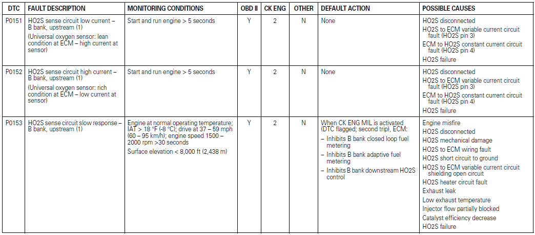

The first question that comes to mind is whether you had any other diagnostic trouble codes besides P0153 that might aid in the diagnosis? It seems highly unlikely that two different O2 sensors would fail in the same way. P0153 can be triggered by a number of issues.
Here's the relevant page from the DTC Summaries manual showing possible causes. Note that HO2S failure is at the very bottom of the list:
You can download the entire manual at the link below courtesy of Gus and his website, jagrepair.com:
2000 AJ27 DTC Summaries Manual
If your scanner can read Live Data, you can observe the outputs of all four O2 sensors to see if there is anything unusual about the output of the Bank B/Bank 2 upstream O2S. If it is responding in a fashion similar to the Bank A/Bank 1 upstream O2S, then it would be worth investigating some of the other possible causes of P0153.
Another test you could perform would be to swap the electrical connectors for the Bank A/1 and Bank B/2 upstream O2 sensors. If you still get P0153, the O2S is not the problem. If you now get P0133 (Bank A/Bank 1 upstream HO2S sense circuit slow response), the sensor or its attached wiring harness is suspect.
