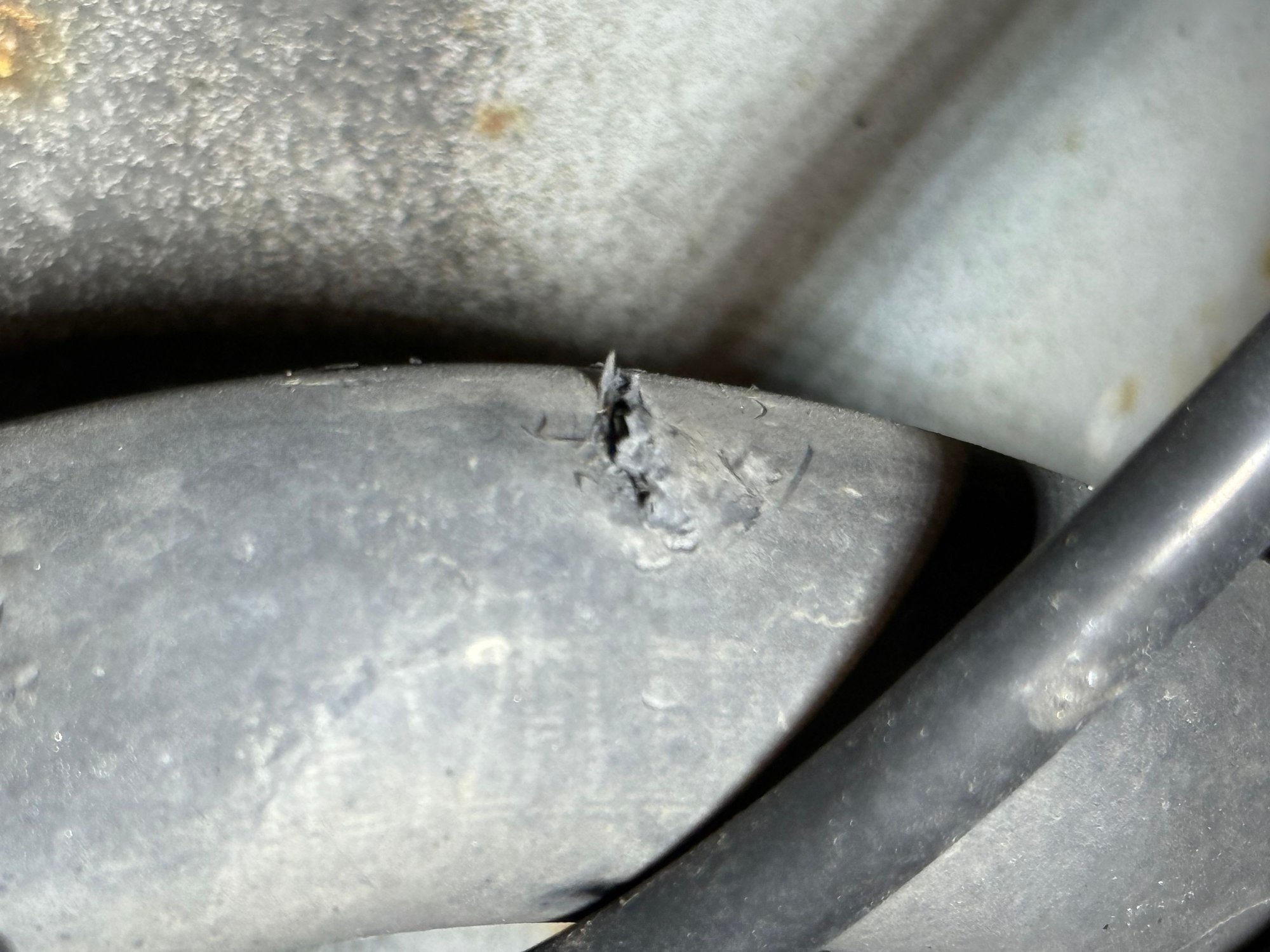

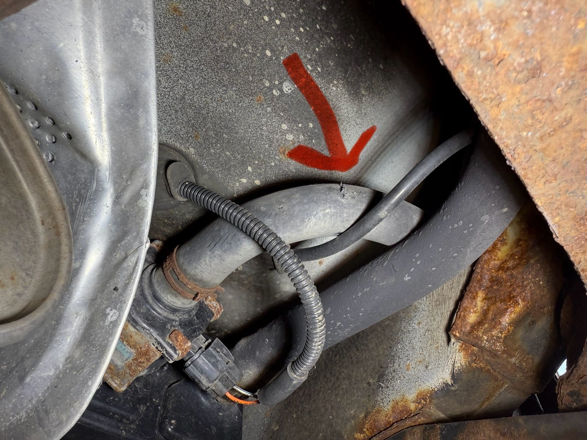

Old Apr 4, 2025 | 01:34 PM
X308TheKingCharles's Avatar
Joined: Dec 2023
Posts: 47
Likes: 6
From: Westchester County, New York
Hi folks, thank you all for the suggestions. After another thorough inspection, I seem to have a hole in one of the tubes from the CCV. Will report back here after replacement to see if the gas smell goes away.
