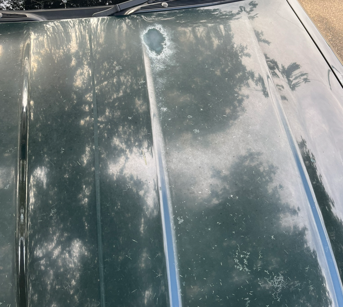

Looking to get opinions, if this is something I can fix myself, or if it'd require taking it to a shop.
Part of hood looks dull, roof looks abysmal.
Thanks

Getting the damaged clear coat off without damaging the top coat is an arduous process.
It can be done, it just takes a lot of time, energy, and most of all patience. There may be
products available today, that make it easier.

In a painfully arduous process I once managed to remove the complete clear coat layer on my X-Type (careful use of a cutter knife mainly and water pressure cleaner) - without damaging the paint.
Then successfully applied new clear coat.
Now my bonnet (hood) shows similar signs. I helped off the first bits of clear coat flakes with a water pressure cleaner. It will take a while for the rest to follow, especially as the car is currently not used and under cover. The UV light of the sun would help to remove the rest more easily....
But in regards of the pictures shown in the initial post/question above: The damage is not big enough yet. Maybe there is a chemical way, about which I do not know, to remove the old clear coat layer WITHOUT damaging the paint underneath, but I'd assume that a complete sand off, base coat, paint and clear coat "operation" is required here.

If the base coat were non metallic it would be possible to remove the clear coat with wet 800 grit and respray clear coat. But with metallic base coat the sanding would change the appearance of the paint and it would be necessary to respray the base coat.

I was using a combination of 40 micron abrasive along with an older style liquid
rubbing compound. If one is VERY careful the clear coat can be removed however
once removed the reflection of the paint changes in that area. Using a good paint booth
is required to even get close to the original paint reflection. In truth, sanding it down and
a respray would be far less labor intensive.

Sorry the paint has failed and the only solution is to sand it off and repaint.
All these half-*** methods will look exactly like that.

Said another way: go see a professional

That's clear coat failure try sanding it with 2000 grit till its flat and then use polishing compound but it may eat up more clear and still look dull . That's large part of the car its possible to paint it with cans but don't expect showroom results . If you have air compressor the diy it but you should know what you're doing . Otherwise just find shop that would fix it with reasonable price always ask for HS clear coat .
