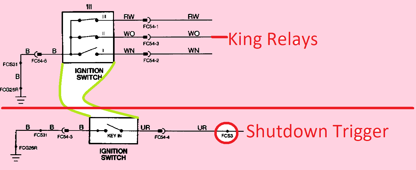

Old Nov 27, 2017 | 07:56 PM
Lady Penelope's Avatar
Joined: Apr 2017
Posts: 4,039
Likes: 1,397
From: Kansas City USA
If it is a parasitic drain beyond the limits we can break the whole electrical system down into electrical buses controlled by the king relays . Or if it has a issue with the go to sleep command . This will get you a better AOA on your approach to a successful trap . Do you have any flags on the ADI or HSI ? The X308 wiring schematic is linked below : The actual schematics are in the last half of the Doc . As they have the breakout sheets up front . It can be downloaded by the arrow in the upper right corner . Color code page 16 . Page 31 has the King relays that I'll refer to as buses . Page 36 is the control of the King relays . And page 78 upper left corner as the Key switch ( Key in/ out ) is the command signal to put the security and locking ECU into the shutdown / go to sleep sequence . There is a multiplex bus Doc. if it comes to that as there is one that talks through all the ECU's although you my not have the test equipment to read it .
http://www.jagrepair.com/images/Auto.../jagxj2003.pdf
http://www.jagrepair.com/images/Trai...-JAG_10-08.pdf
Owners Handbook :
http://www.mediafire.com/file/s48q3k...e+Handbook.pdf
Shall we proceed ?
Findings on ignition Switch : Jaguar part # LNA6507BA
By removing connector FC54 9 inches straight forward of switch found ground pin 5 contaminated , cleaned
The pin side of the connector pops off the bracket straight down to be able to hold in free space .
Black wire socket position 5 to ground = 0
.........On the pin side of the connector :
Black wire pin position 5 to pin 1 key position 2 = 50 ohms Run position
Black wire pin position 5 to pin 2 key position 1 and 2 = 0 ohms Acc position
Black wire pin position 5 to pin 3 key position 3 = 30 ohms and bad large waver as moving key radially ( needs replacing later ) Starter
Black wire pin position 5 to pin 4 key insert = o ohms , key removal = open ohms this is the security ECU input
http://www.ebay.com/itm/1995-96-97-J...EAAOxywOtSXf2r
Attached Thumbnails Parasitic battery drain-x300-drain-31-untitled.png   Parasitic battery drain-jaguar-key-switch-s-l400-1-.jpg
