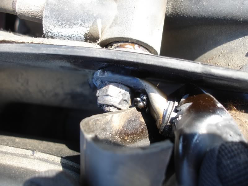

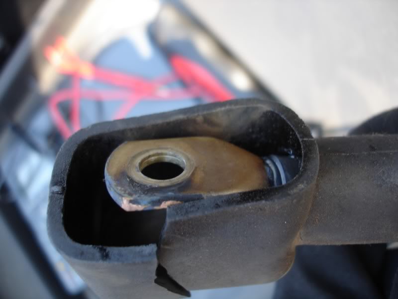

Basically the thing melted. I was able to disassemble it, and do some cleaning, and "jerry-rigged" it back. I still needed a jump since the battery dropped to 11.3v. But it started right away with the jump. Let it run for about 10min, revving it up. The connection still gets hot, but it'll have to do for now.
Pics self-explanatory.

In the first picture, there is a nut/thread connection under the insulating boot.
One reason it is still getting hot is that there is still a connection with resistance in it ... probably the one that has not been disassembled.
There is no direct surface contact between the leads. The current path is terminal face>nut face>nut thread>stud thread>stud>stud thread>nut thread>nut face>terminal face. So, all of those contact points need to be clean.

Ouch! That's ugly. I'd like to take credit, but that info I got from this site. Mine was a bit loose, but not like that! It looks like a nice jury rig job you did.

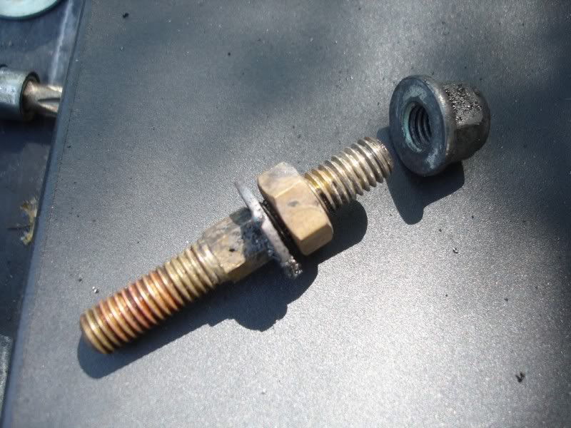

Today I had some time, (and hardware stores around) to get back in there and see what's going on under the rubber boot on the cable going to the starter. And like you suspected, it wasn't pretty, since the whole stud was still getting hot after I cleaned the exposed part first.

Got some metal brushes, copper washers, and new nuts, cleaned the whole thing and assembled back. Night and day difference. No scorched finger after 1min of running. Bottom line, if anybody else runs into the same issues, make sure you disassemble the WHOLE thing on both ends and clean it good.

It's a common trouble spot and a bad design.
You have to really think about it to realise that the current flow is through the threads.
If the cable eyelets had direct contact, that is the cables were both on the same side of the bulkhead, then the current flow would be directly across the contact faces. There would still be some flow through the thread on the nut because of the path from the outside faces of the eyelets but the main path would be directly across the inner faces.
An inline barrel type cable splicer would cure the problem permanently as long as there was sufficient slack to cut the eyelets off.
