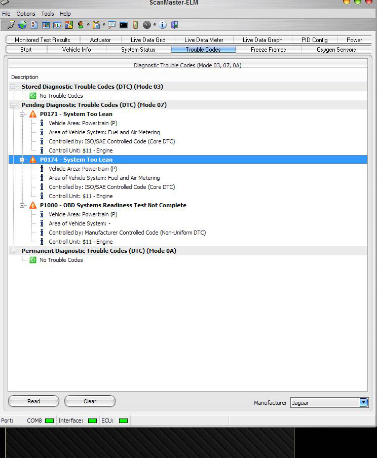

It's been a long wait for the OBD scanner, with the Restricted mode becomeing a permant fixture most of the time. Although forcing (if thats the right way to describe it) the engine over 3000 rpm would remove the warning for a limited time. Today was the worst of it with the car running very rough from start whilst I ran errands. Which continued with every start.
However the scanner arived today and after trying several Bluetooth devices and programs finally found a match that would connect with the scanner.
Scanmaster ELM running on my Win8 64bit tablet
The software has far more functions than I will ever use, and took a little getting used to but I did manage to pull the codes on a very rough running engine.
Pretty self explanitory I think except for the P1000 code. So I cleared the codes and reset the check engine light. (such a good feeling to get rid of that yourself), shut the car down for about 15 mins. then restarted her. No check engine light, no rough idle, and now the throttle was far smoother. So I took her for a 10mile run. Everything seemed right untill about 90mph and she would become hesitant and would feel like she was miss firing.
Anyway no check engine light and no Restricted mode. Got home and reran the scan tool.
Again no suprises, and I guess the lean mixture could I assume cause the hesitation at high revs?
I have been reading about the P0171/174 codes, I guess this is not going to just be a trip to the shop for a mixture adjust.

There are several places that air may be leaking to cause problems.
The trunk from the air cleaner to throttle body (TB), remove it completely, flex it gently to see if there are any cracks, especially along bottom. While there, check the resonator, ( blanked tube about 4" long sticking out of side of trunk). These are known to crack at the joint with the trunk.
I think you mentioned the seal between trunk and throttle body.
Check o rings on full load breather, between trunk and cam cover, drivers side.
Check part load breather tube, small one , passenger side, runs from cam cover, under inlet manifold, to TB. It suffers a lot from temperature.
There are some vacuum hoses which run from TB to a module on the baulkhead, which are part of the fuel system vapour recovery system.
If that doesn't fix it, somebody may have disturbed the inlet manifold and re-used the old seals.
If you are not running lean at low speeds, but running lean at high speeds, that is a fuel delivery problem. That is because a vacuum leak is masked at high speed since it forms a smaller part of the total air delivery.
The two major causes are a clogged fuel filter and a fuel pump on the way out. The fuel filter is relatively easy ... the fuel pump not so much. Fuel pressure can be confirmed at the schrader valve on the fuel rail.

I haven't had any time to pursue this fault due to having a parent on both sides of the family in hospital at this time. I have however now done over 3k miles on the XJ. Hopefully I will be able to spend more time out of the car and resolve this issue, which now seems only to occur after starting the car and last for perhaps no more than a minute or two. After that it does not happen again regardless of driving distance.
ohhhhhhhh....diddo on that gum out.....its a miricle worker....so glad of your results....with the reader/scanner.....went through what you went through along time ago with my 85 xj6...what a car......i eventually was unable to get the car to move forward in drive..(but worked in reverse)....thought the trans had gone.........it was a throttle body/linkage issue......good luck....
Another possibility is lazy O2 sensors, although your symptoms seem more dramatic than I'd expect from that.
