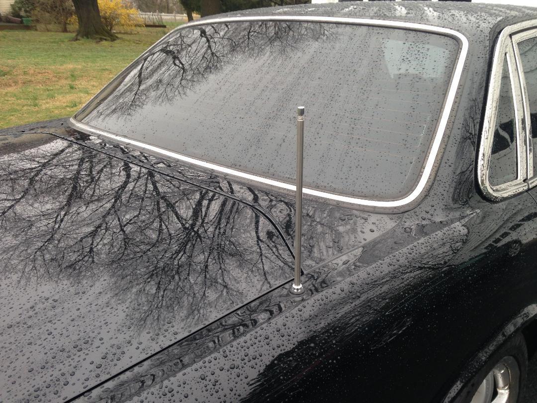

Recently purchased this car and the antenna didnt work at all, no motor noise or anything. After inspection the motor was unplugged and worked perfectly, but the mast was damaged. Replaced the mast with this:
https://www.amazon.com/gp/product/B00BDVIWU0/ref=ppx_yo_dt_b_asin_title_o02_s00?ie=UTF8&psc=1 https://www.amazon.com/gp/product/B00BDVIWU0/ref=ppx_yo_dt_b_asin_title_o02_s00?ie=UTF8&psc=1

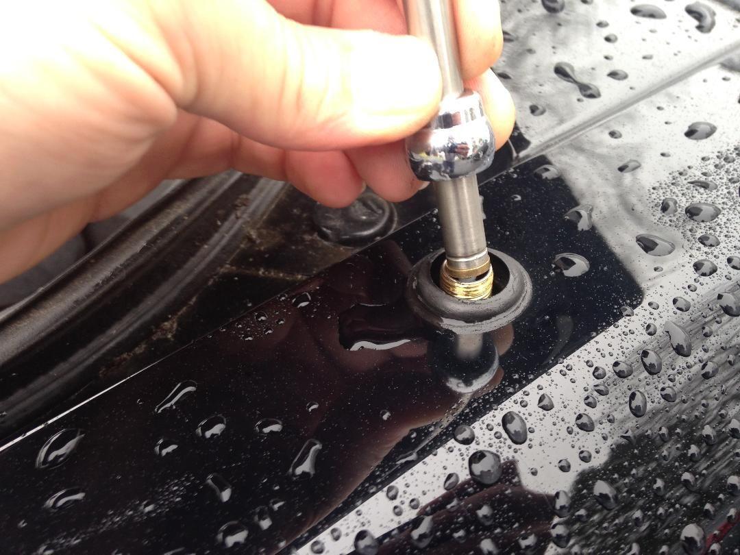

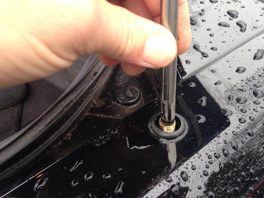

Replacement was easy and went smoothly, antenna now goes all the way up and comes down. However, it does not go all the way down. The antenna base is larger than the motor's tube. Here are a few photos to show what I'm talking about.
The first & second photos show the brass spacer on the bottom of the new mast that is preventing it from going in the OEM tube. The third photo shows and adapter that came with the new mast and that will not go inthe tube either. The last photo shows the antenna at full down position with the lock nut installed. It doesnt look bad at this height, but it's not right and I'm a bit baffled as to what is going on here. I doubt I got the wrong mast, but I guess it's possible. The motor assembly looks original with original Jaguar part numbers so I dont think that has been messed with. If anyone has any ideas or has run into this before I'd appreciate any info you may have

Could the lowest section of the old antenna tube be stuck down and blocking the new antenna from installing? It should just drop in and that sleeve with the tab, in the second photo, should slide in as well, and lock in place. The brass ring will slide up and stop against it as the antenna extends. It could be a poor fitting part, but the part number is correct. I got the URO version off rockauto, same PN, and it fit with no issues.
If the sleeve by itself is too big to fit into the hole, you've probably got that old outer piece jammed inside there. The toothed cable would be independent of that issue.

You guys were spot on, the little clip in my third picture was still stuck in there from the old one. Just collapsed it from the top, pulled it out and the new one went in perfectly all the way to the bottom. Looks so much better all the way down. Thanks again guys. Now on to other projects...love this car.
