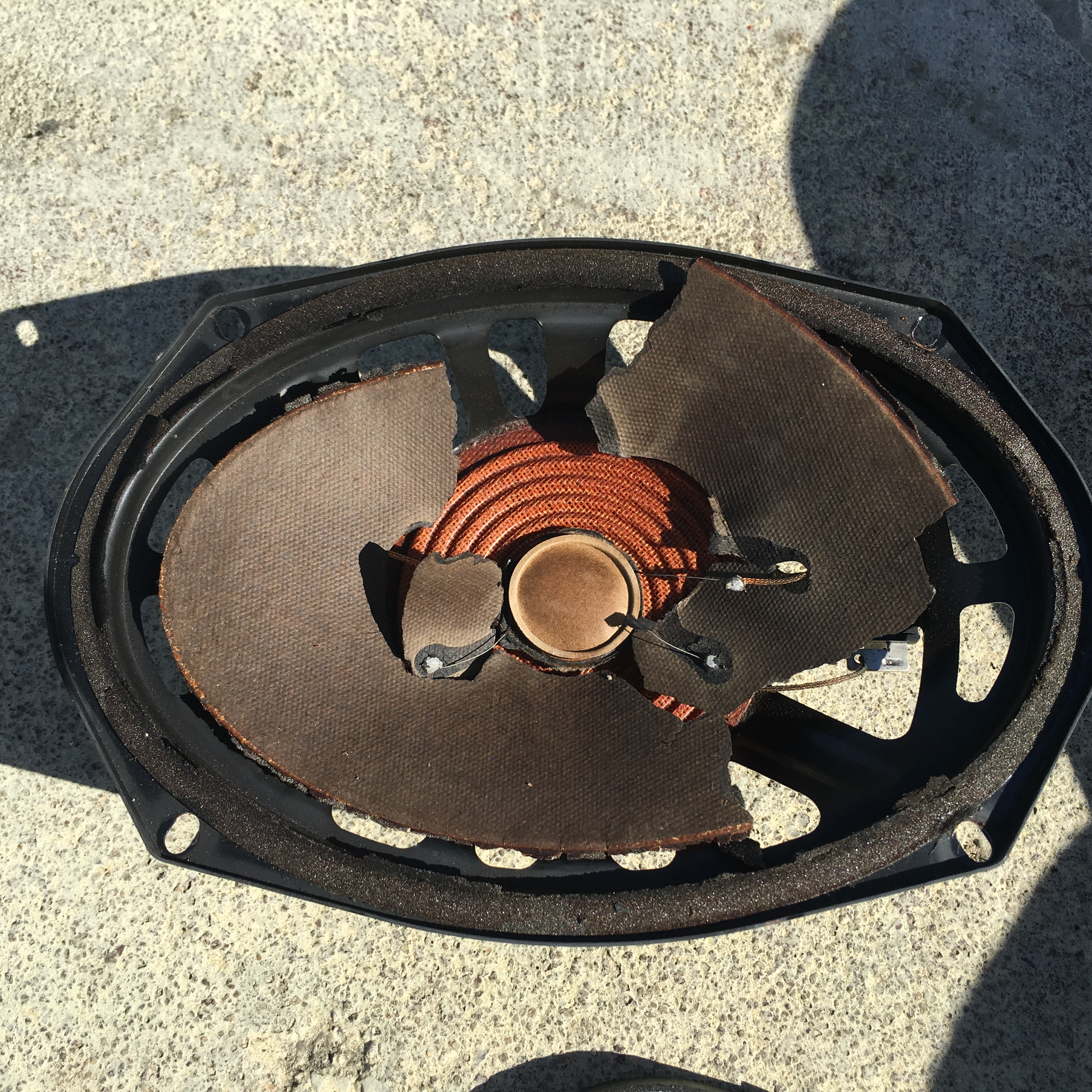

Ok, just got it installed. It sounds fantastic. There was clearance above the gas tank, not much mind you but clearance none the same. Almost a drop in replacement. Had to widen the width a bit but was easily done with some hammer tapping...see pic. My original was not fixable....also see pic. So if you are looking for an after market replacement that can go in the factory hole this works! It won't upload more then one pic per post for me so 1st here is my blown factory speaker.

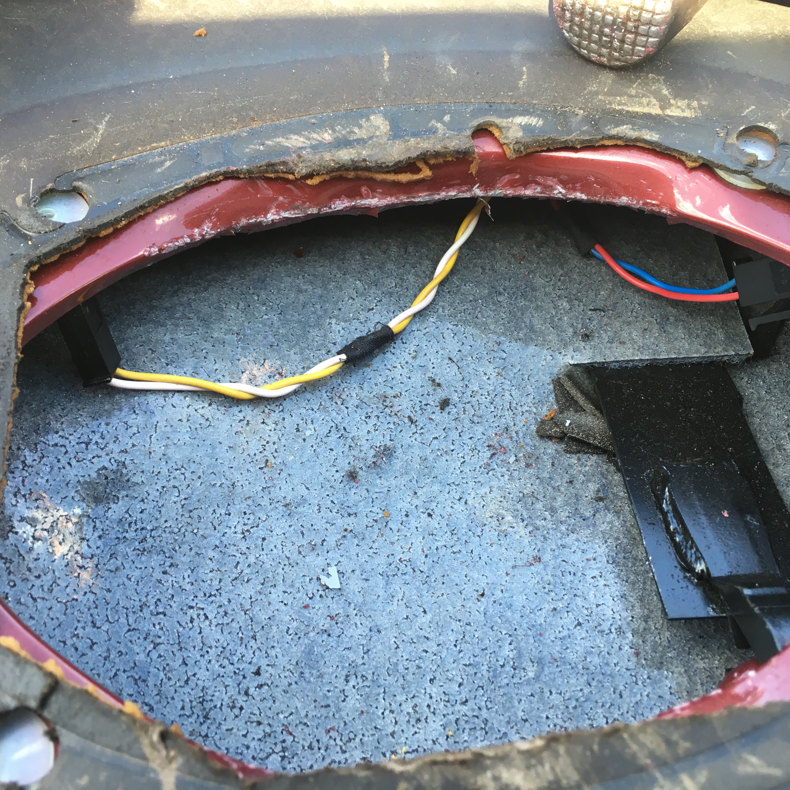

Next is the slight width modification needed. Just hammered down the metal lip of the hole a bit on both sides.

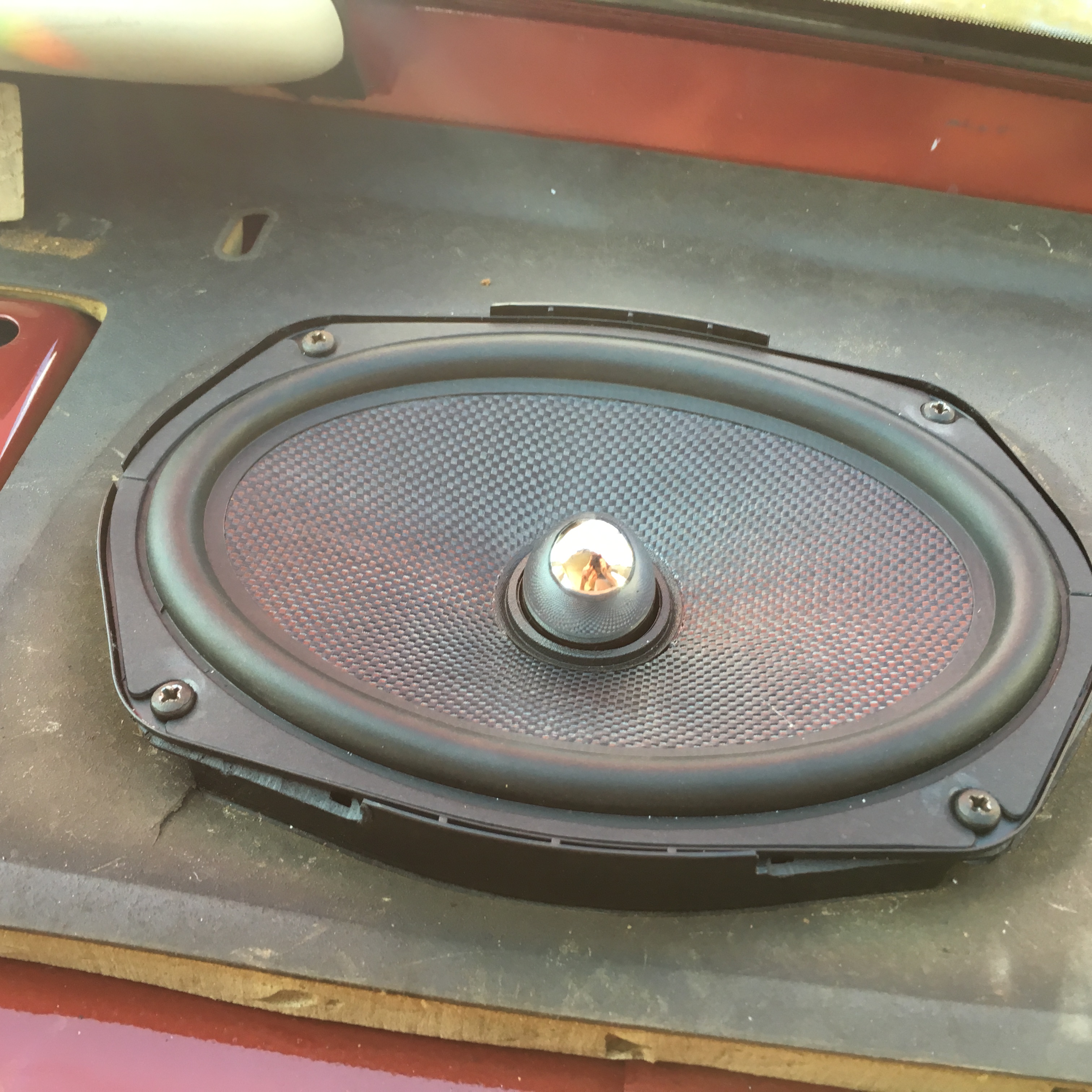

Last is pic of it installed. We used the factory spacer and the rear deck and original grill fits beautifully over it.

New install looks great. I'm blown away (no puns intended) at how bad your factory was. I'm used to just seeing the foam disintegrate but the cone in pieces is just ouch!
Glad to hear it's in and sounds great, I'm about to fire up a ton of overtime at work, so I'm hoping to get to my own experiments over the next few weeks.
