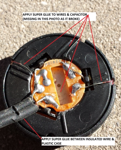

I found that I blew the tweeters. Searching on line and at the dealer the front tweeters are no longer available. The rear tweeters are available, so I suspect since the fronts have their own amp and are no longer available that blowing them is a common problem (when you play your stereo to loud).
After a lot of searching I found ones that will fit in the original location. Below is what I did in, every other option would require modifications that would not look original.

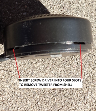

This is what the tweeter looks like out of the package
In order for it to fit in the pillar I had to remove the tweeter from the shell by splitting it in two at the seam using a screw driver
This is what it looks like out of the shell
The tweeter has delicate wire and parts inside as I broke the capacitor for the crossover. I fixed this by dabs of super glue on the wires, capacitor and circuit board.
The tweeter fit well but I had to put to dabs of super glue to hold it in place in the pillar. The tweeter sounds brighter that the original but is not harsh. I think the reason is the replacement is a piezoelectric and the original was dynamic type with a magnet for the motor.
