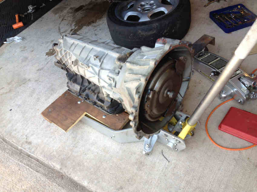

Finally got the tranny out. Fortunately I haven't broken anything and didn't burst into flames (it's 100F+ here in TX today).
Now I'm trying to determine if the rear main seal is bad if it is the oil gallery bolt that is leaking. There is an old thread on that topic, so I posted it over there: Where else can Oil be leaking
On a car that has seen road salt, I would say that pulling the tranny is quite the job. Lots of stuck stuff. It took a good 3 hours after all the bolts were out to walk the tranny off the alignment dowels. This car has at least been in TX for the last 11 years.
The jack I used worked well. It is a modified unit for pulling Porsche 911 motors, but it's almost like it is custom made Jaguar XJ8 tranny jack :-).
-Mike
-Mike
