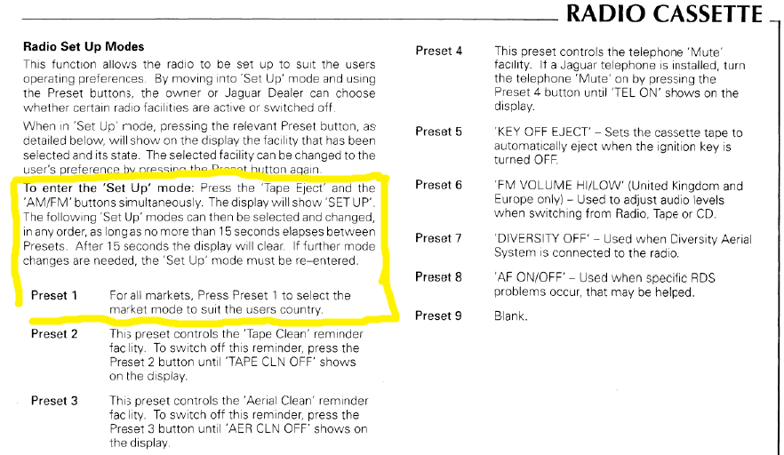

Hi, I have XJ8 2001 and american version. Is it somehow chance to program or switch radio frequences to europian?

Hi.
Try this, see attachment:

Thank`s Oyster, it works!
