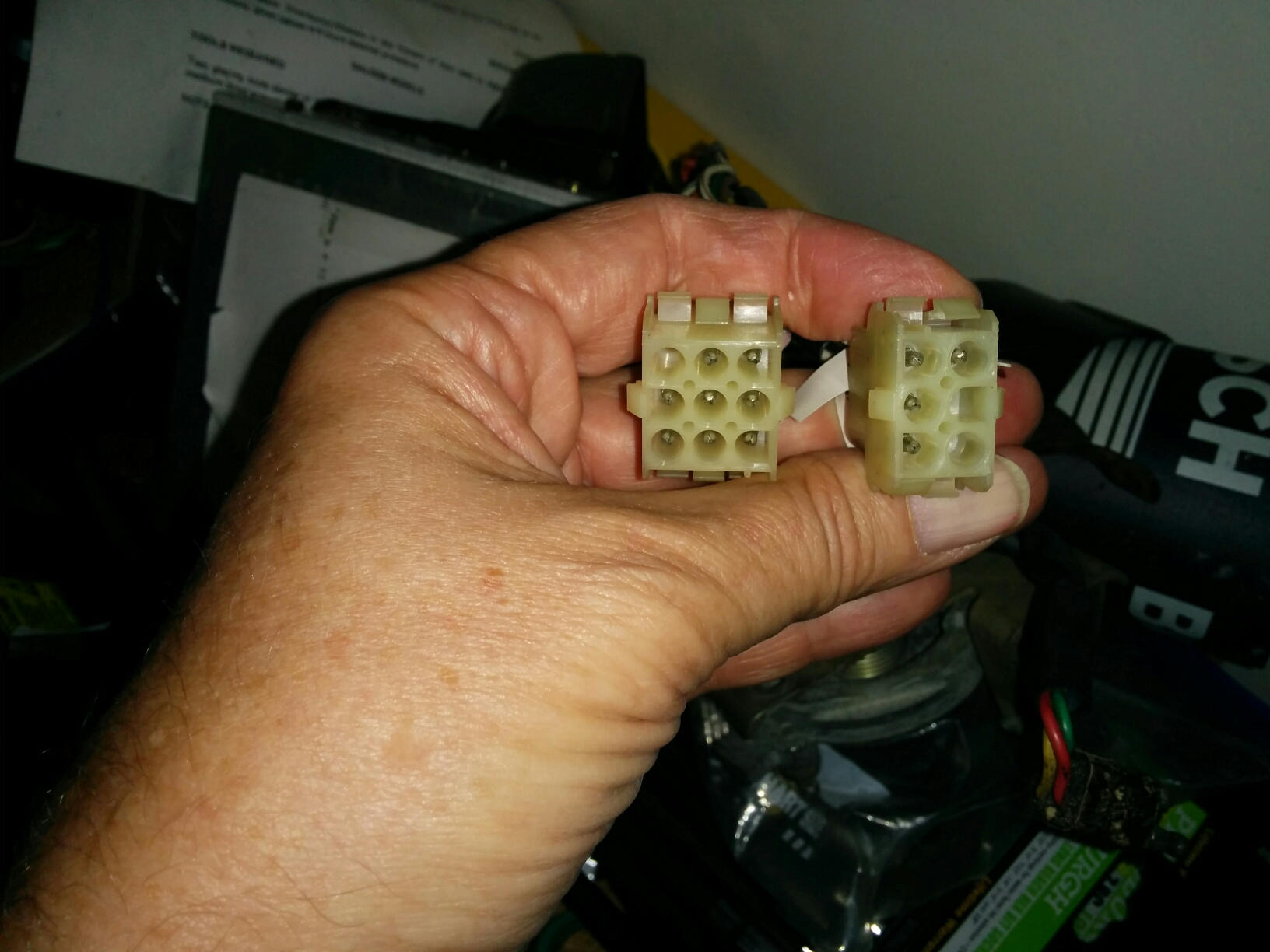

Default Radio/Stereo Adaptor Plug to Replace Pull Out XJS Unit with a Modern one
FWIW, not all replacement radios use the ISO interface. So you might need an additional adapter between your new radio, and the ISO plug.
Also, for those with older vintage XJSs, that adapter won't work with the two white plug connectors on my 85 and 87. The factory harnesses on my cars have round pins in the two white connectors.
Radio/Stereo Adaptor Plug  to Replace Pull Out XJS Unit with a Modern one-1463058559177.jpg
These are the connectors coming out of the radio.

The white connector will work to connect to at least my car (92) but then you will need an ISO to "whatever stereo brand you are using" connector. The last time I checked, each manufacturer was consist across its range (ie all Pioneer stereos have the same plug) but each manufacturer is different. Kind of annoying....... But maybe its part of their policy to keep you to their brand. I must admit it does influence my choice.....
Attachment 129791
