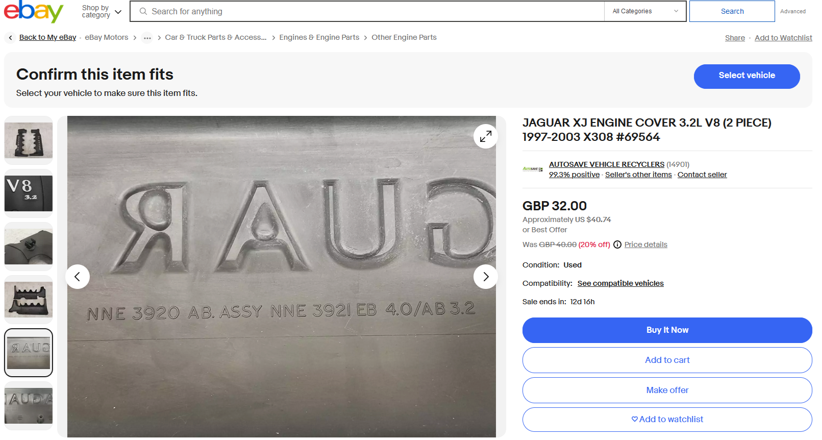

I cannot do a proper search here in the US because we don't have any 3.2 's and any part # comes up for a 4.0L. On the one item I did find for a 3.2 (of course it was eBay), a set of trim covers for the motor, it does say 4.0/AB 3.2 by the part # in pics, none of the 4.0L cam covers had clear enough pics. Hope this helps, just gotta do a bit of elbow grease to bring'em back would be my suggestion.

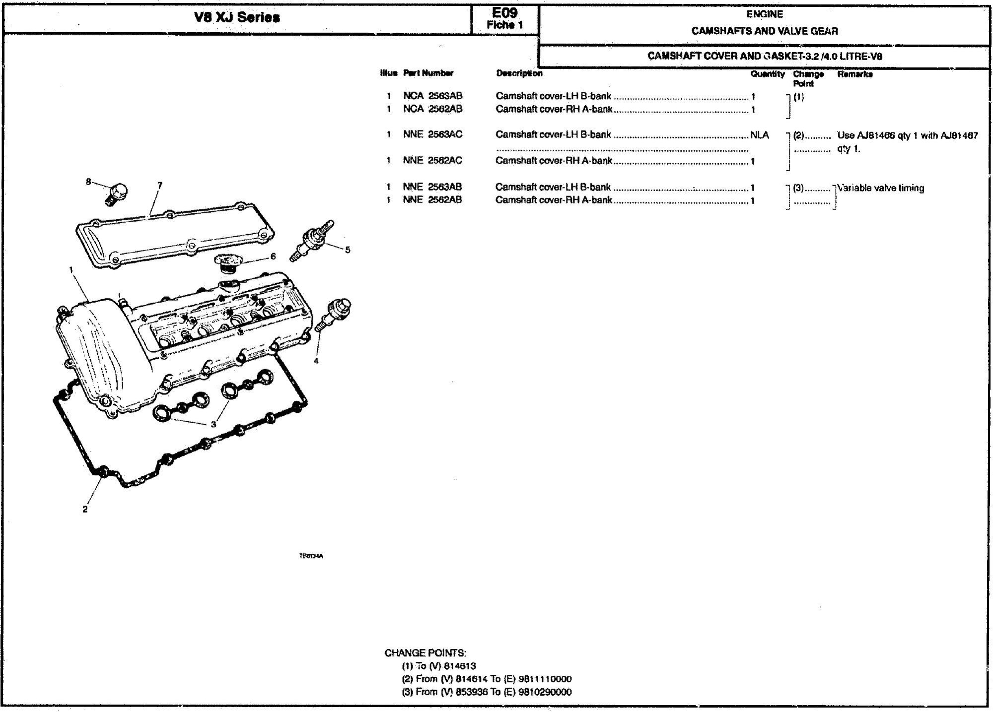

3.2 Lit. engines did not have VVT (but verify that this is the case on your engine, just to make sure), so the cam covers you need should be either the first or the second pair shown on the diagram depending on your VIN. However, according to SNG Barratt website, both have been superseded by AJ81466 and AJ81467.
On the other hand, SNG Barratt show that cam covers C2A1513 and C2A1515 are for X308 without VVT.

Thanks, M.: of course, the Barratt Catalogue! I plain forgot that one...And yes: I do not have VVT (I know that, as I swapped the timing chain already). I also come to the conclusion now:
LHS cam cover for 3.2L (and probably also 4.0L) without VVT: C2A1513
RHS cam cover for 3.2L (and probably also 4.0L) without VVT: C2A1515
