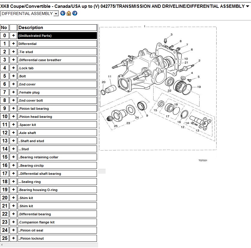

Hello
I have to replace companion flange kit on a diff- the one that connects to rubber propshaft coupling.
Have anyone done this before? I guess I'll need a new shim kit to tighten all back together properly... any instructions available on how to install that flange properly? I guess wrong torque on the nut will damage the diff?
https://www.jaguarforums.com/forum/a...fferential.jpg

Jaguar discouraged the replacement of the 'seal only' and offered a replacement assy.
The procedure and 'parts required' list is in the TSB section of the file download area but here it is AGAIN!!!!!!!!!!
