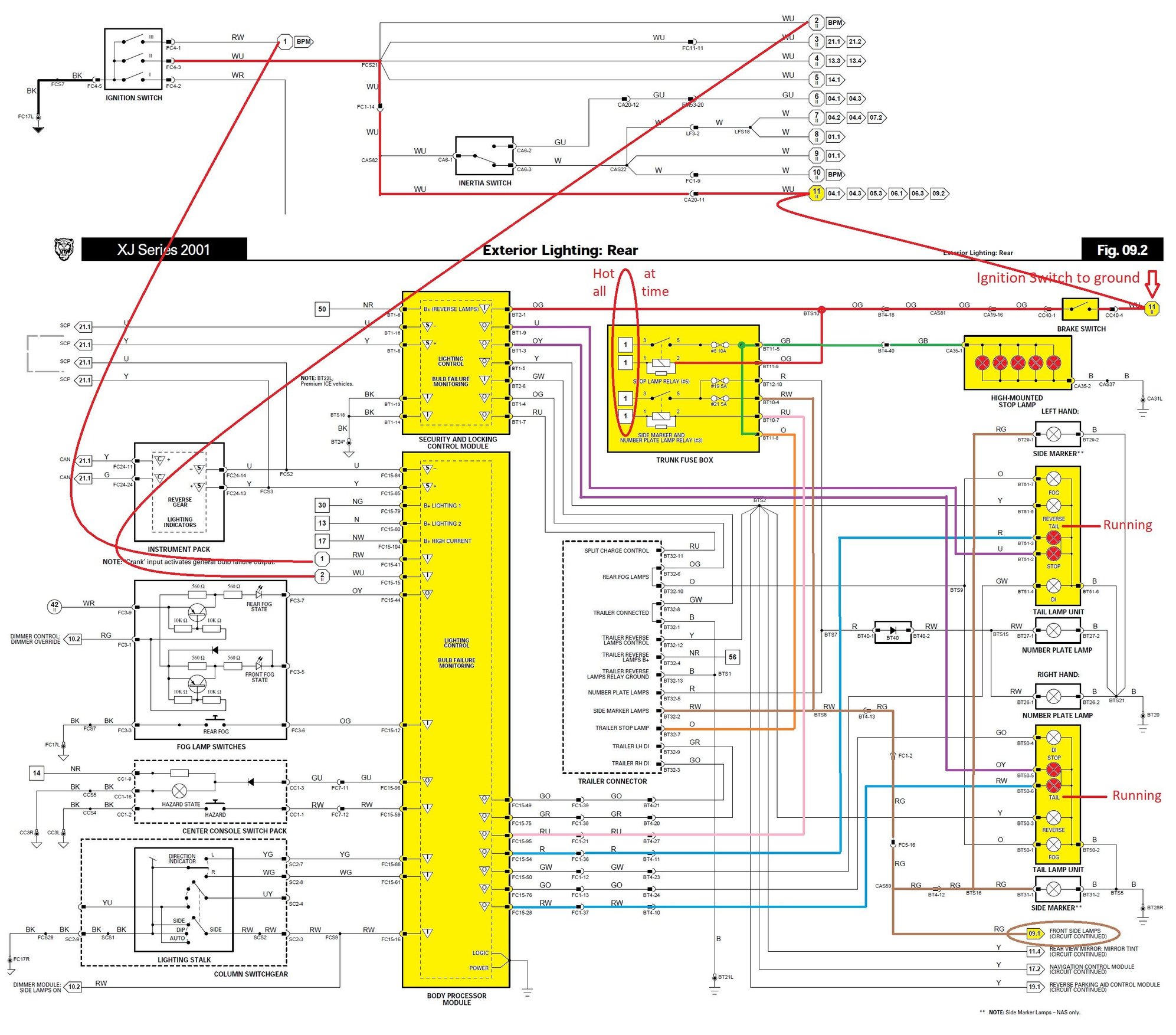

There is a wiring guide I made for the brake light to give you the big picture
notice they didn't make it easy
You can take this doc on a flash drive to the office supplies stores and can print any size and even laminate it

Notice , I did previously mark the print as running , this has to do with the rear tail lights as I was working with someone else in the past and saved my print
Notice the trunk fuse box as the yellow square involving both a fuse and relay , you can place your finger on the relay and feel it click closed
