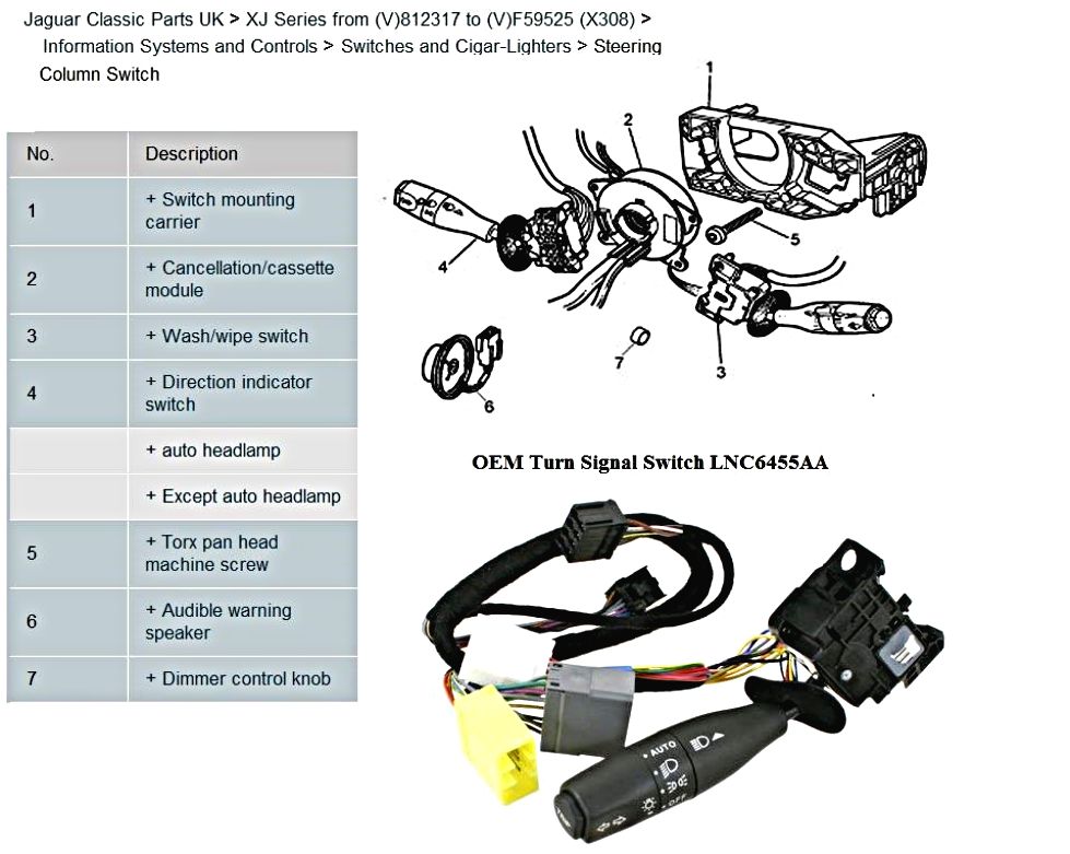

Here is a JPEG file showing the parts with illustration and photo:
Sometimes a picture is better than 1000 words.

randy..yes mine has auto stamped on what you have shown as #4.....do you remember what you paid for it?.....and thanks again....

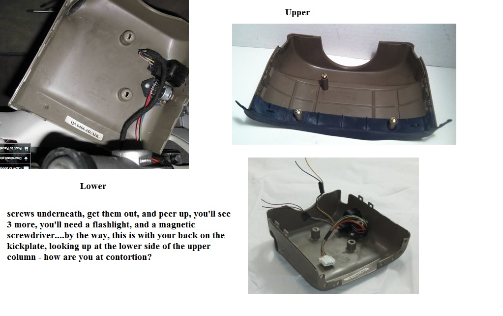

Here is a couple of photos of the lower and upper steering column cowlings:
The comments are from another thread on the forum.
Jim Lombardi
