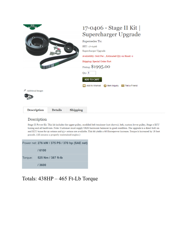

This is what's on my XJR-100, not sure if XK's still carries it. A bit pricey.
Attachment 135926
Pricey for sure but thats a huge gain, and looks like a simple mod. Labor ought to be cheap if its not DIYable. How does it feel on your car?

I've driven several XJRs and mine is by far more potent. Mine had the mod on it from the PO when I bought it so I can't give you a direct comparison of before and after.
