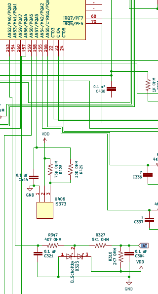

The resistance from the IAT sensor (EM-82-17) goes to an analog to digital converter pin (AN53) on CPU1, there is not much to go wrong with that as far as the ECU is concerned (unless everything is dead, and if the car starts, most things must be ok)
- The voltage is measured based on 5V voltage fed via 2k7 resistor, which feeds the IAT thermistor which is grounded on the other side, then via spike protection circuit into the CPU A/D converter.
