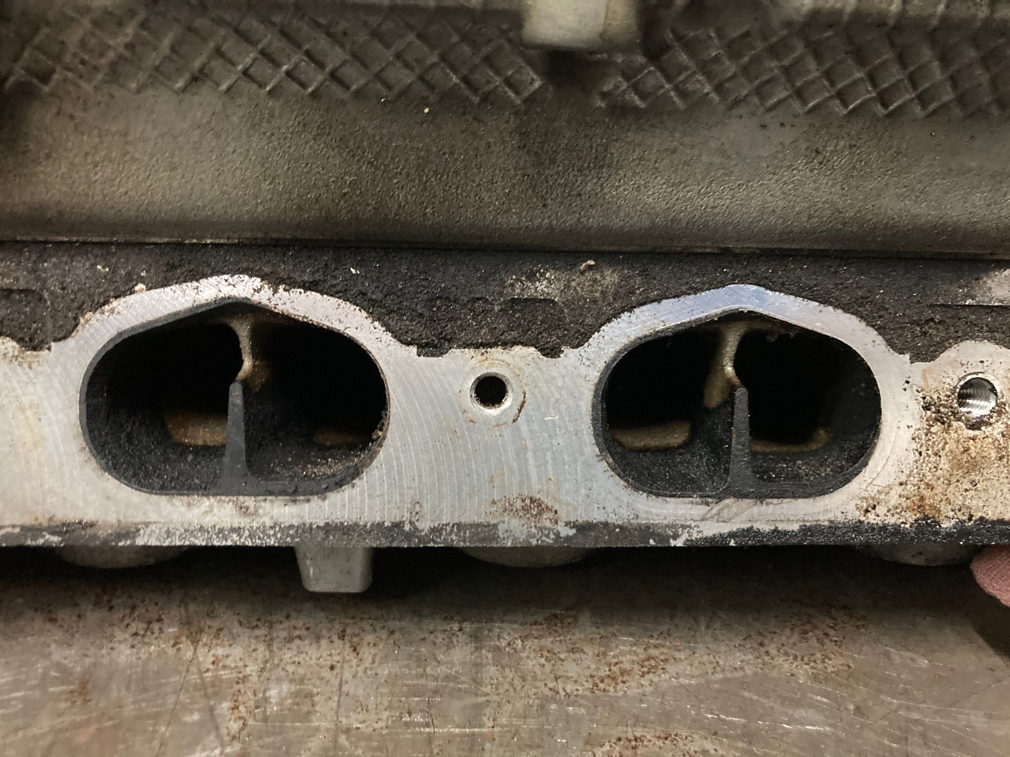

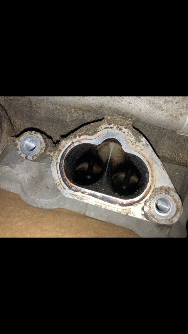

The above photo:
This is the intake runner from an AJ26 head specifically but, I’m pretty sure the AJ27 intake runner is the same.
This second photo is the intake runner from an 05 4.2 XJ.
I didn’t look into the combustion chamber differences (if any?). Not to step on anybody’s toes but, I don’t think getting one 4.2 cylinder head would be the ideal situation for you. I can verify that the later 4.2 mls head gaskets will work on a 4.0 block and are truly superior to the earlier head gaskets.
I have 2 thoughts. 1) You can likely get the 4.0 cylinder head repaired. I would HIGHLY recommend getting the other head sent off for a valve job so they’ll both have a fresh valve job, new valve stem seals, valve adjustment and machined heads for a slightly higher compression ratio, it’ll run great. 2) if you get a 4.2 head, I’d HIGHLY recommend getting them both but, who knows if the factory 4.0 intake manifold will bolt up and seal to the 4.2 heads.

you need to drill a couple new holes for the 4.0 manifold to fit the 4.2 head.
repairing the head seems like a no brainer as long as it’s just a dropped seat

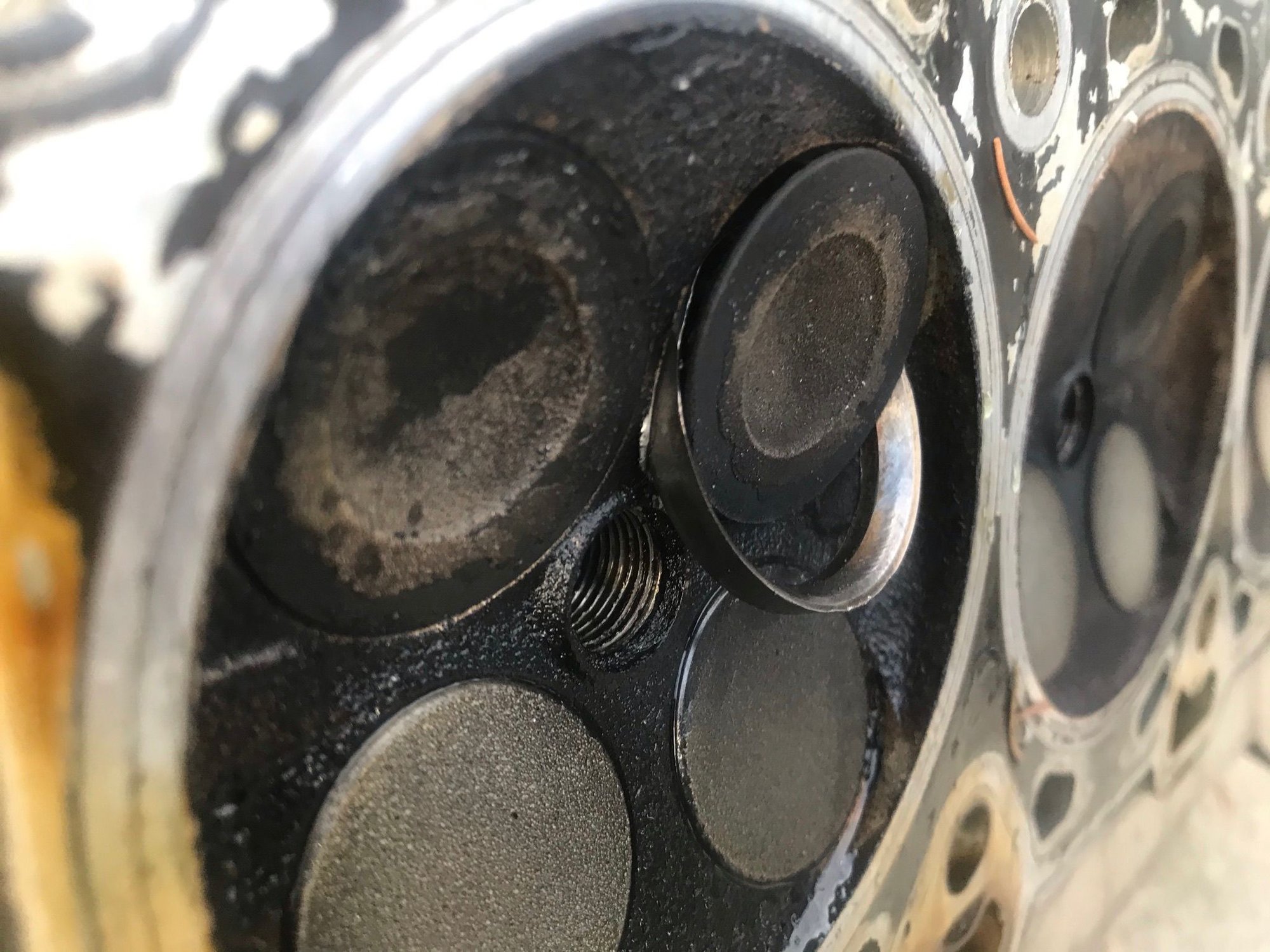

Hello picture number 17 was for information only it’s a 2000 XJ8 with a broken intake valve. What caused it was a broken timing chain. The valves got loose inside the head and banged on the piston so I lost the motor because the cost of replacing the piston to plus the cylinder head Could have gotten a hotspot because of the beat marks after it was rebuilt.

I posted another photo of an XJ8 where the valve seat had dropped down. What caused it was the car overheated.
