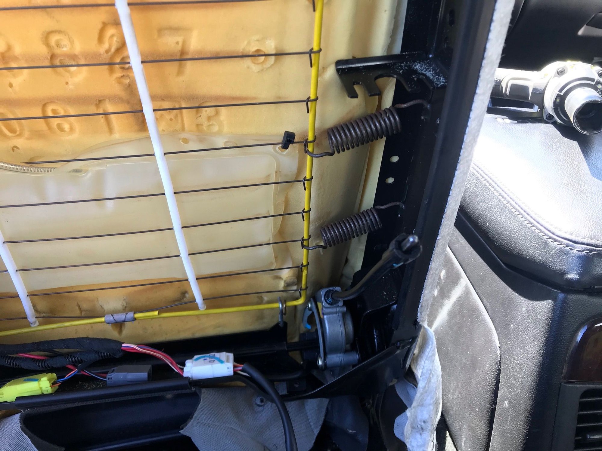

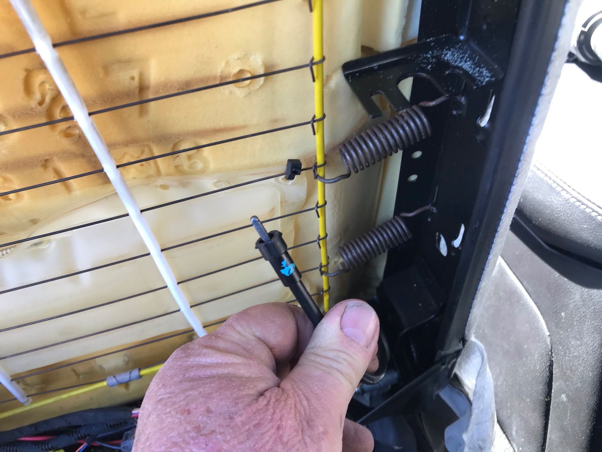

So before you do that maybe you can test to see if you’re gearing‘s OK bye putting a cordless drill on the cable that comes out of the motor. If the gearing is good the cordless drill will make the seat go up and down. I went through this a month ago they’re a little bit complicated but if your motor is spinning your cable might not be in all the way
Good little nugget to know...

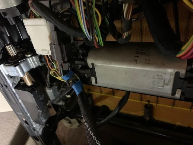

Motor good. Bench tested. One of the tracks was jammed. Could only turn with a vice grips. Other turned by hand. The worm gear in the gear box stripped the plastic gear.
