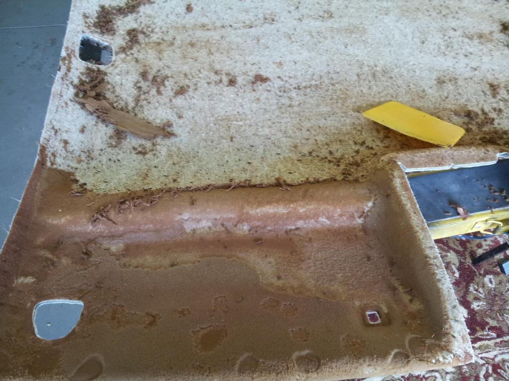

Then remove the old liner and start removing the residual foam. I found a paint scraper did the trick.

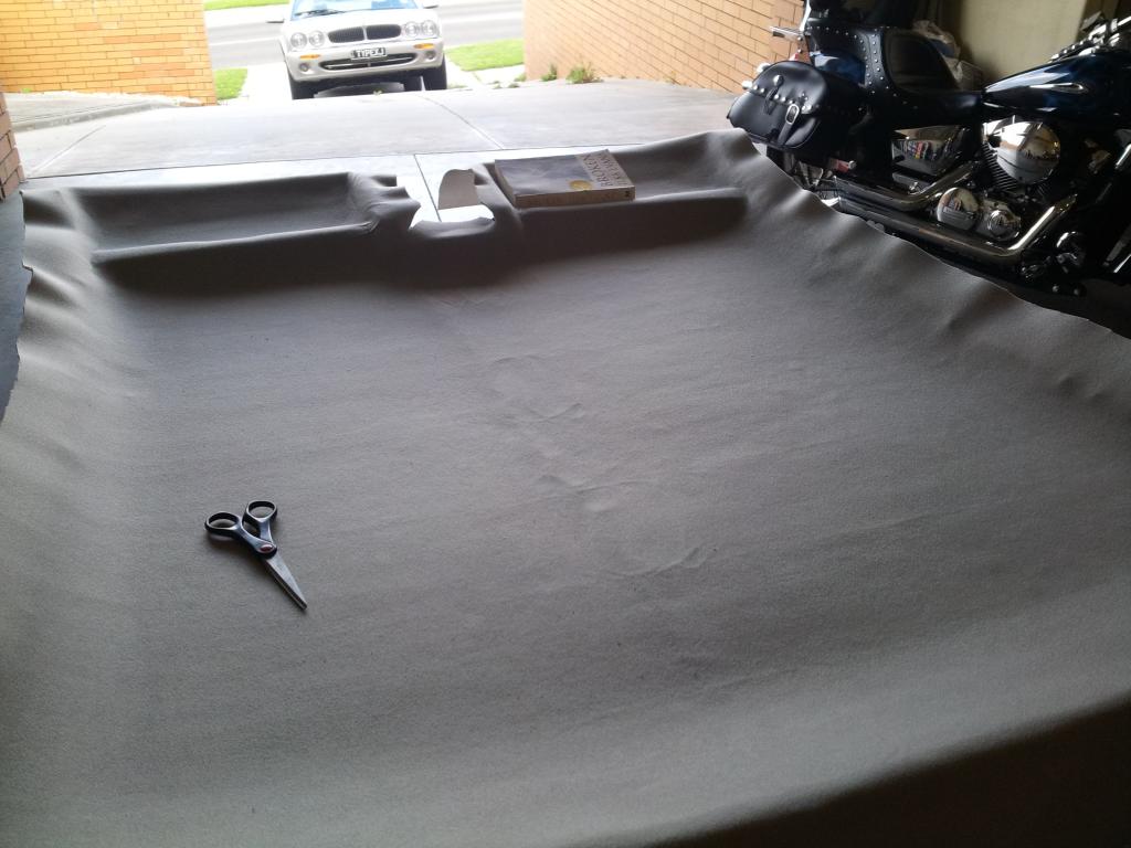

Cut a new piece of material leaving a bit of extra over hang which can be trimmed later.
Use some good contact glue and glue it straight over. Just cover up the holes for now and cut them out when it dries.

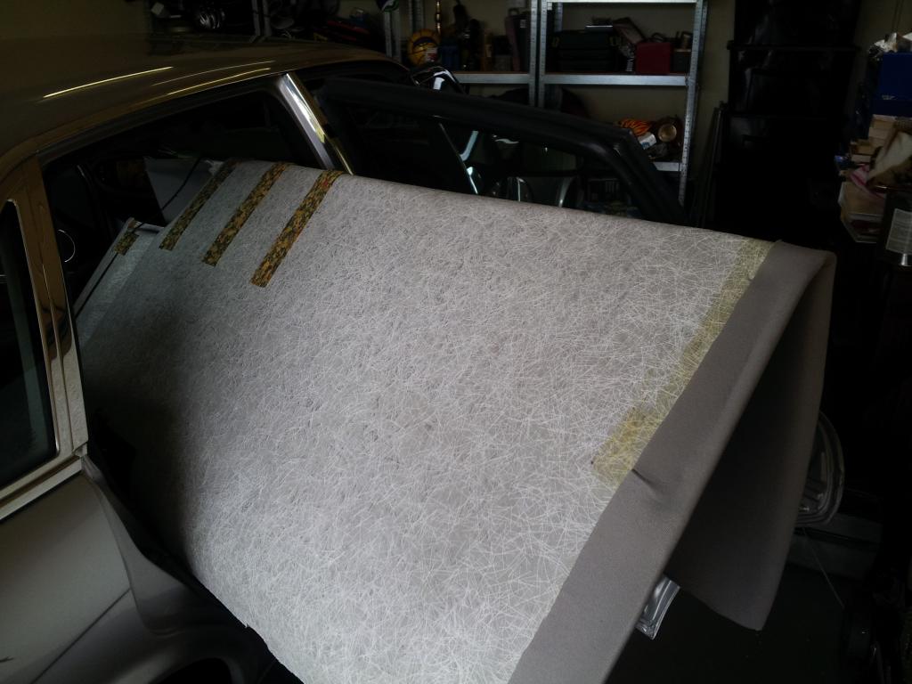

*Warning*, if you push down too hard trying to smooth over the contours near the front you will find the glue seeps through and it will ruin the look.
You can see here where the fold was, it will be less obvious in time.

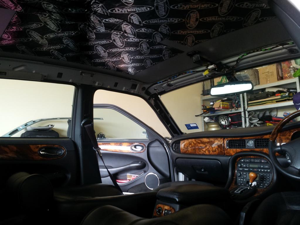

I took the opportunity to put in some Dyno Matt as well before putting everything back together. I don't know if it will do anything but I figured it couldn't hurt.
Then reverse everything and put it back in. You can still see the crease but it is barely noticeable.
