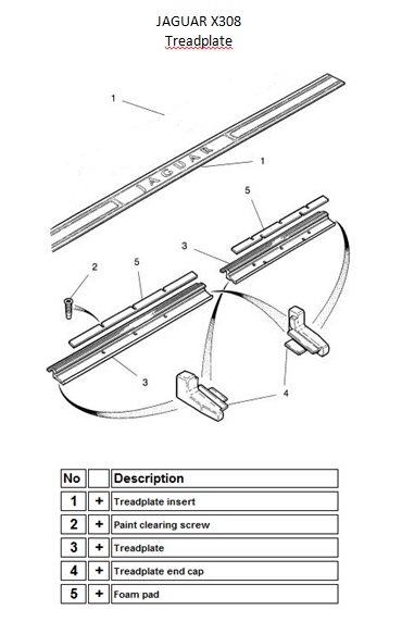

The parts manual diagram shows how the treadplates are fixed:
The insert (item 1) is glued down and easily damaged. Some report using a thin plastic spatula and others have used fishing line to free the adhesive after removing the end caps.
Attached Thumbnails Rotten - Inner Sills to floor pan - investigating ?-x308-treadplates.jpg

I have just taken my tread plates off and used an old chisle to gently pry up the Jaguar insert which is held by double sided tape. There are 3 screws holding the front plate but for some reason best known only by Jaguar there are 5 screws holding the rear plate on.
I tried getting the tread plates off with fishing line. It look like it could work but I was'nt sure if I would run out fishing line or patience first. I got one off intact using a large chefs knife and a heat gun. I started at one end, having taken the plastic end plates off, with the knife just gently sawing under it whilst getting it hot with heat gun just ahead of the knife. It took 5-10 minutes to work along but it pays not to force the knife too much and let heat weaken the sponge foam and glue. Don't get it too hot as you don't want to damage the paint. My heat gun had an adjustable heat setting.

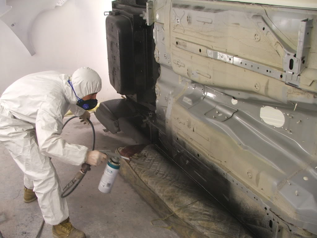

..... I like the rubberized undercoating that 3M (#08883)
in the UK it's called Schutz stone chip - awesome stuff....
3M Car Body Schutz - Black Underseal 08861 x 6 - OFFER! | eBay
My new body shell got a *few* liters...(After paint it got the Bilt Hamber Dynax treatment too, it won't rust for a long time)

Sean B, thats some photo, I have been lying under my car scrubbing, scrapping and painting, getting covered in Sh1T thinking it would be great if you could just flip the car on its side. However I don't have the time or facilities for a full strip down, renovation and rebuild. I have a big yard, a workshop, but no garage. You don't have another similar photo showing the bulkhead between the engine bay and passenger compartement by chance ? I am trying to trace a leak from just below the wiper motor area through the bulkhead, I suspect it is tracing along the harness through a large rubber grommet just below the wiper motor.
