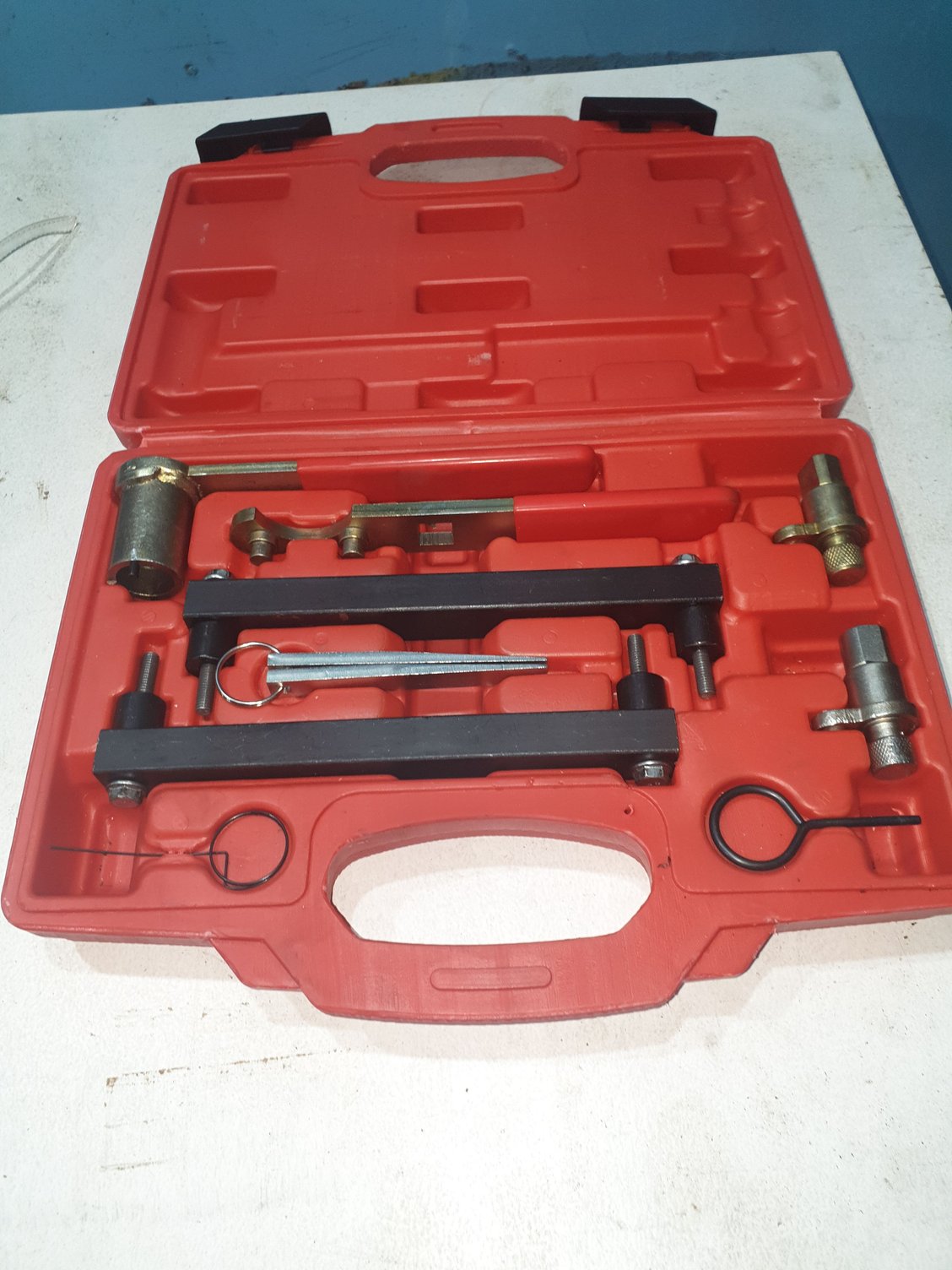

Did you use the camshaft locking tools that lock crankshaft and camshafts at 20 deg atdc
and then camshafts sprockets are torqued at 20 nm then 90 degrees
these engines are one of the best to do timing on
once I finished my complete engine rebuild mine was rough on start up
it took around 2 minutes for the vvt to settle down
