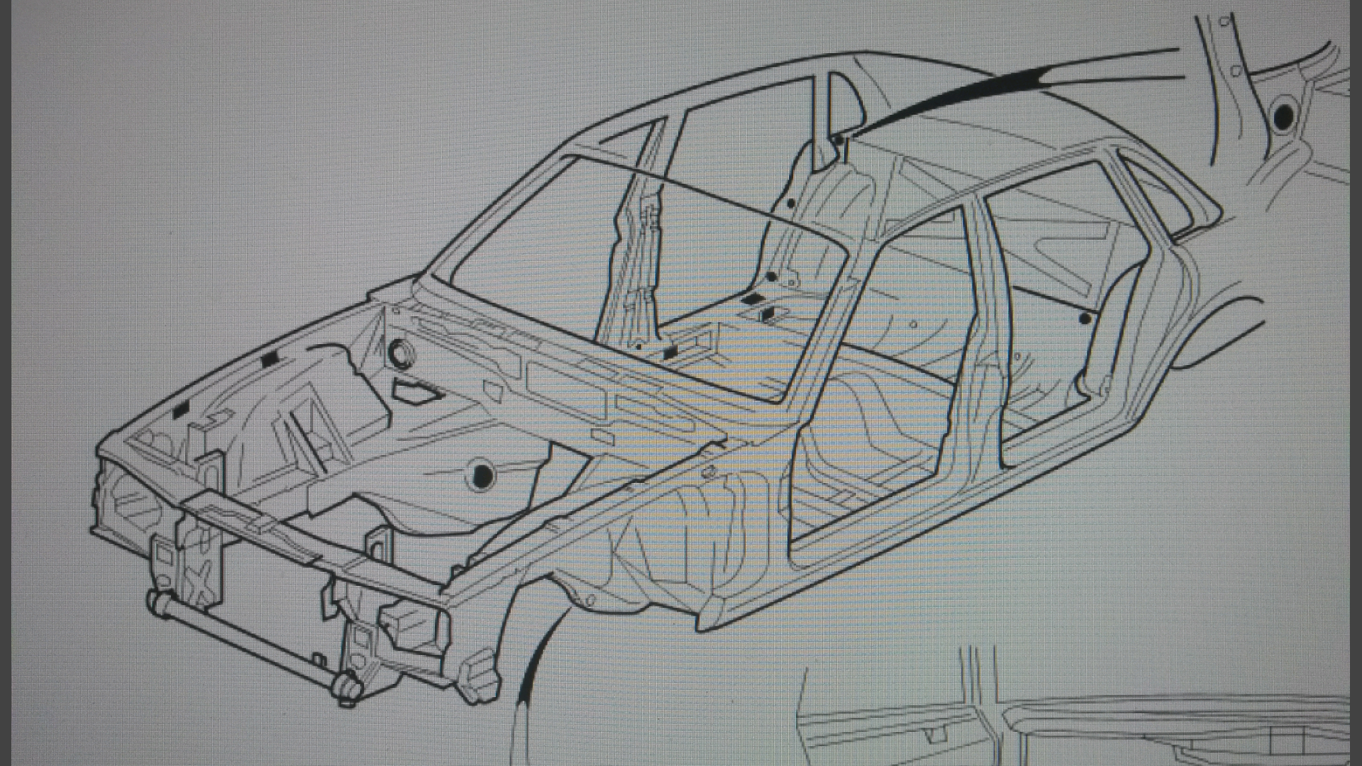

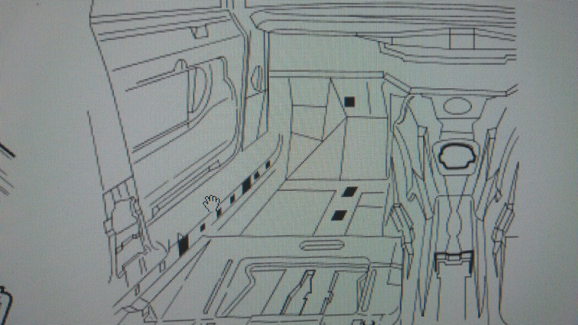

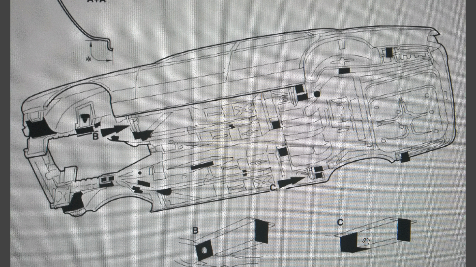

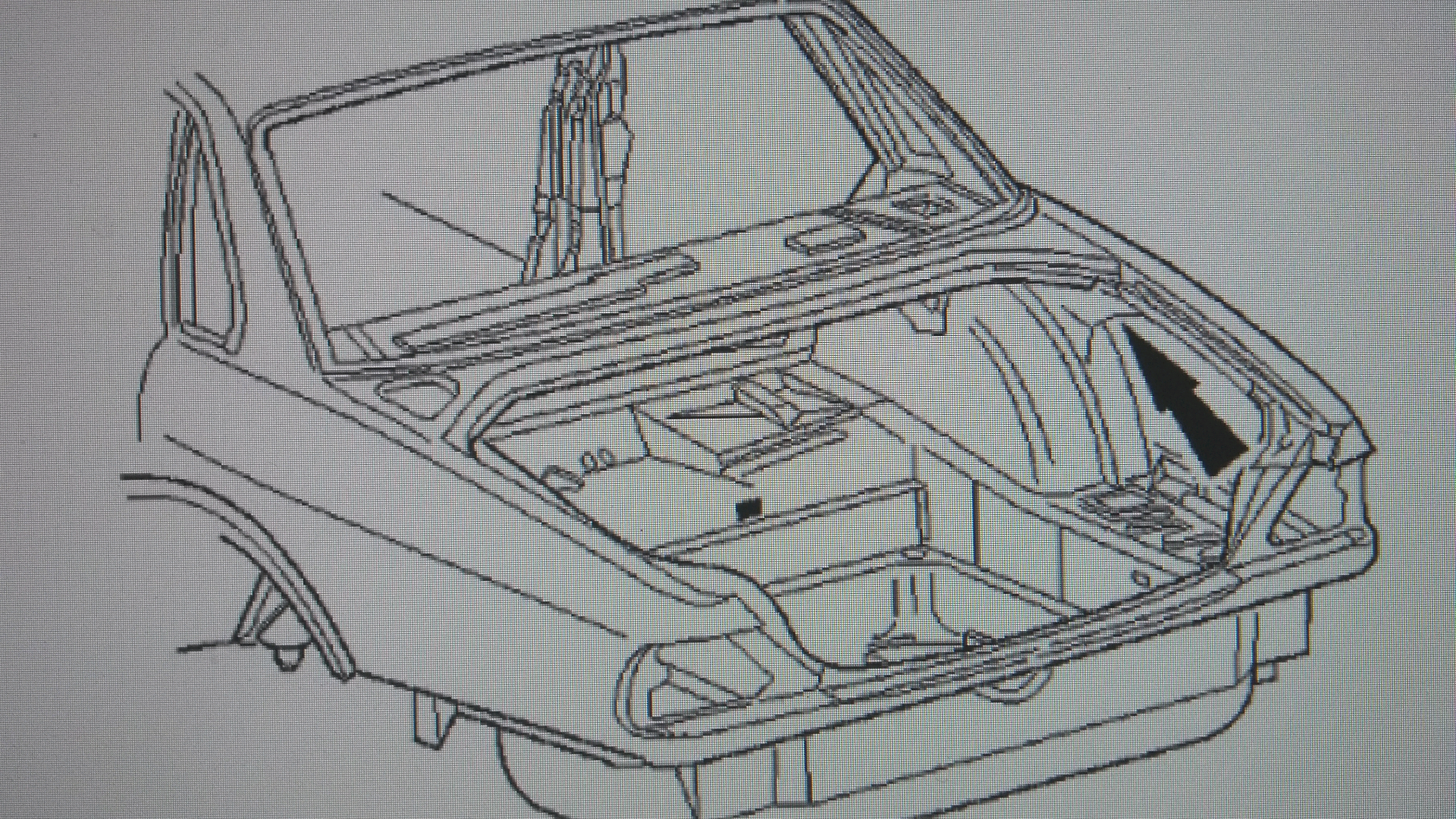

Oiling points for the chassis from the manual
Spray liberally underneath I guess!
Inside rear wheel arch oil point?
Lift up the carpet to get to the sill oil points?
Seeing as it's coming towards that time of year again, I've had a go at firing some dynax spray into the chassis but was wondering if anyone has any tips on where to point the long wand type attachment around the car? I've already done the inside of the chassis legs by drilling a 5mm hole, which saves me having to remove the bumper in future hopefully.

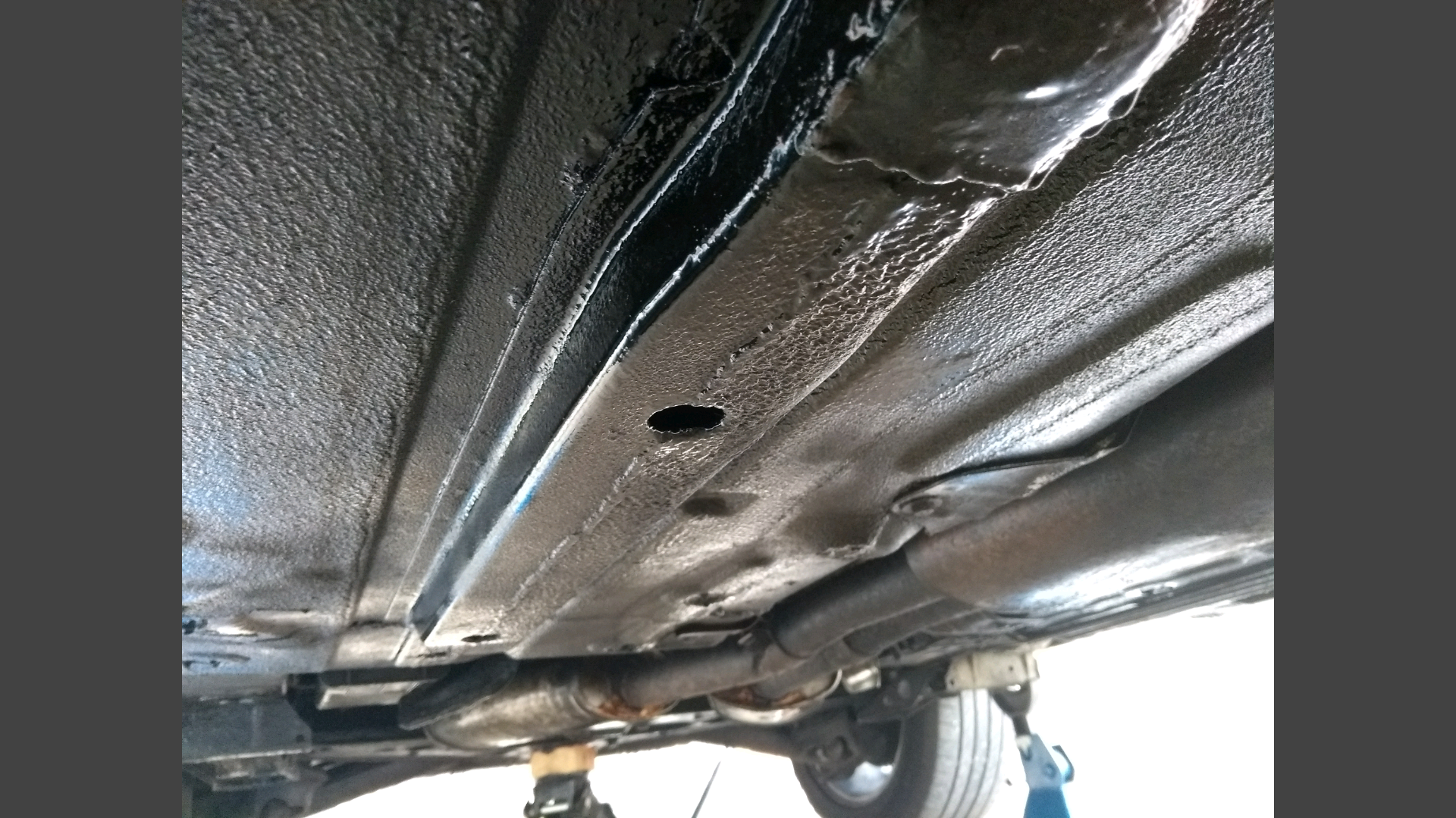

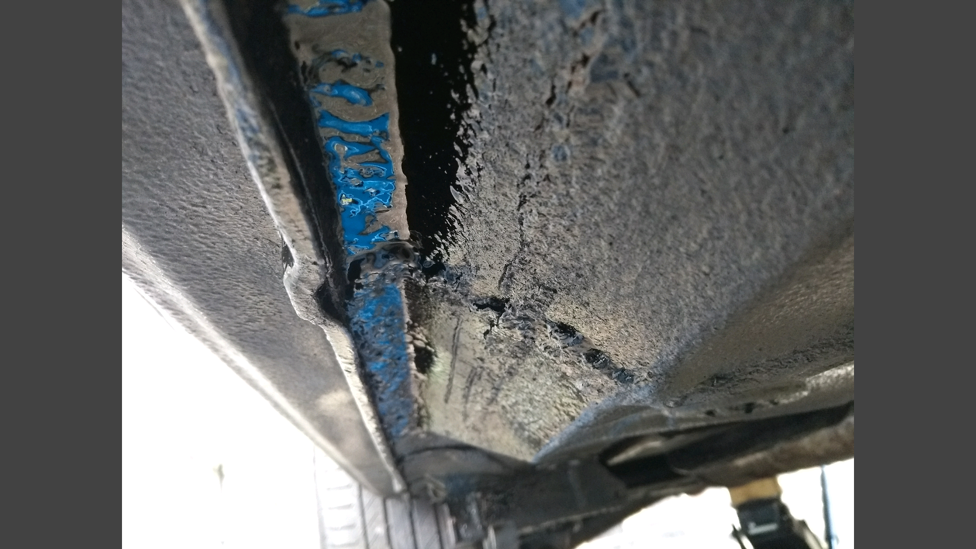

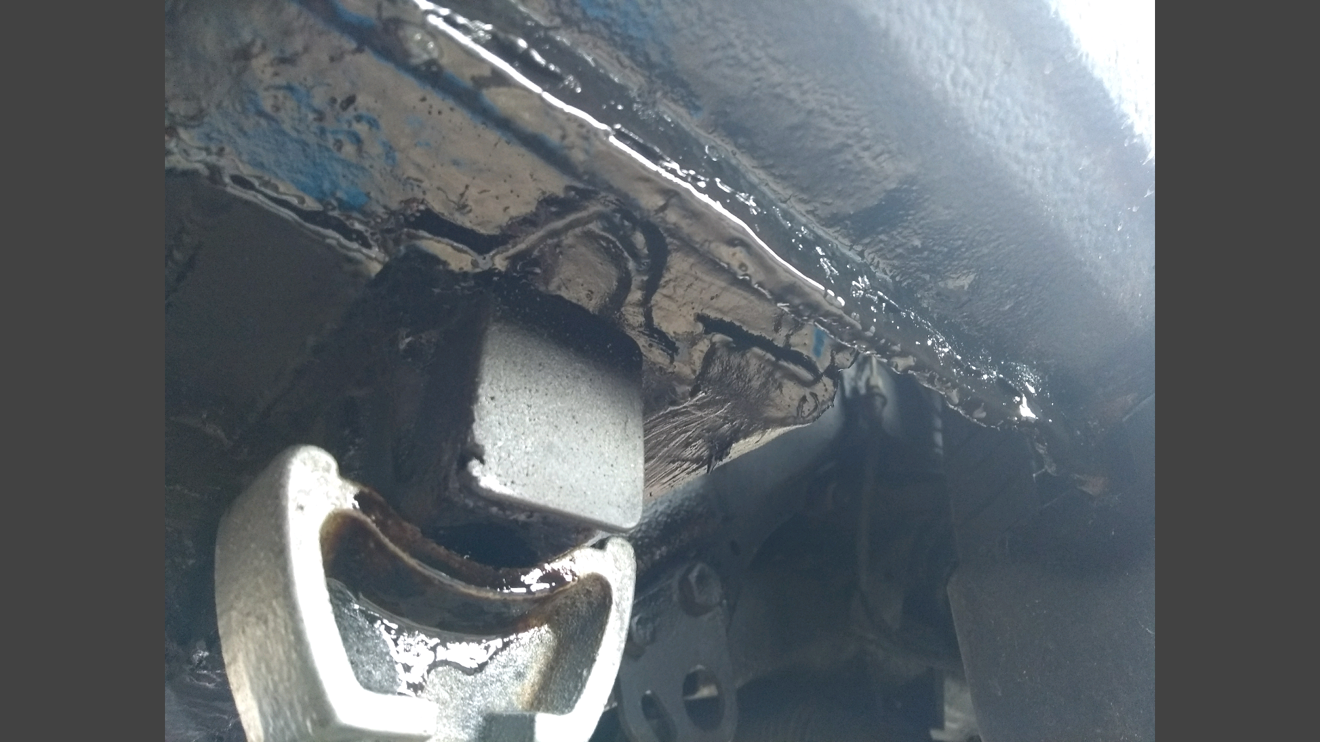

Sean, I used dynax S50. I think it's just a mix of old oil and petrol style propellant but it dries quickly enough. I think two cans would be enough as an initial hit. Over the summer I addressed that nasty area around the front subframe so didn't really have to redo that.
Worked from the front to the back under the car. Some method seems to help I think. Used the normal spray nozzle initially, then followed up with the internal wand. Used the wand on the holes in the rails underneath and in the holes in the inner wing.
The floor pan plugs "knock out" holes were beginning to get quite crusty, so they got special attention. Think I'll need to get the welding gear out again next year.
As an fyi, that dynax can needs to be turned upside down to fully use up the contents. There's a good amount left in it otherwise.
