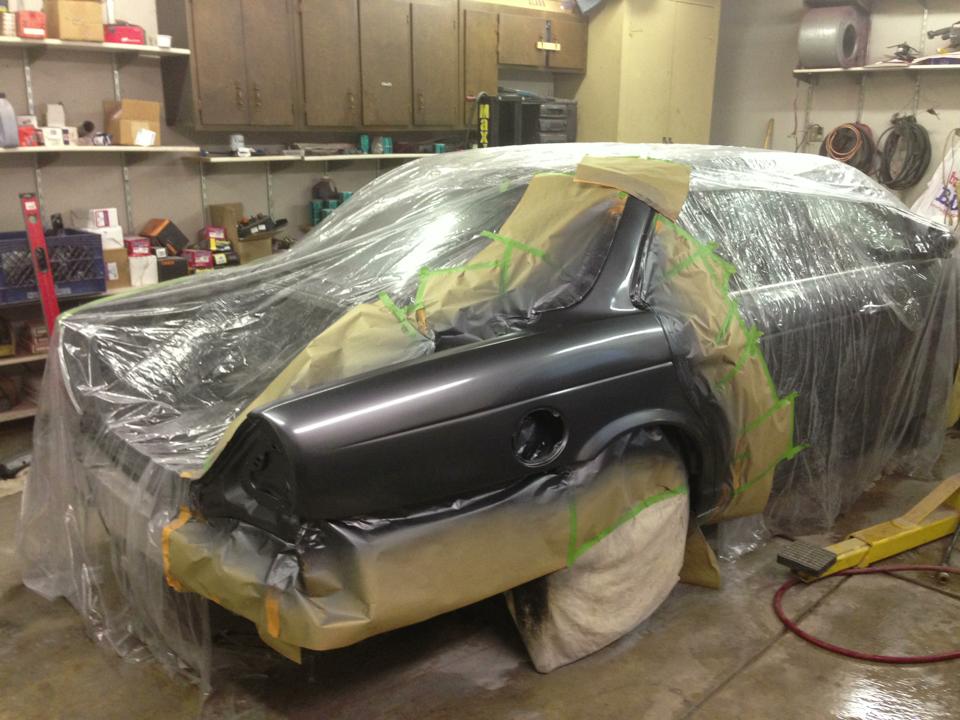

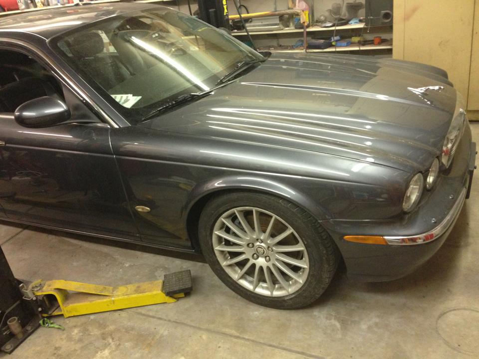

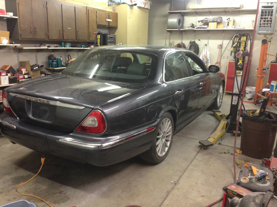

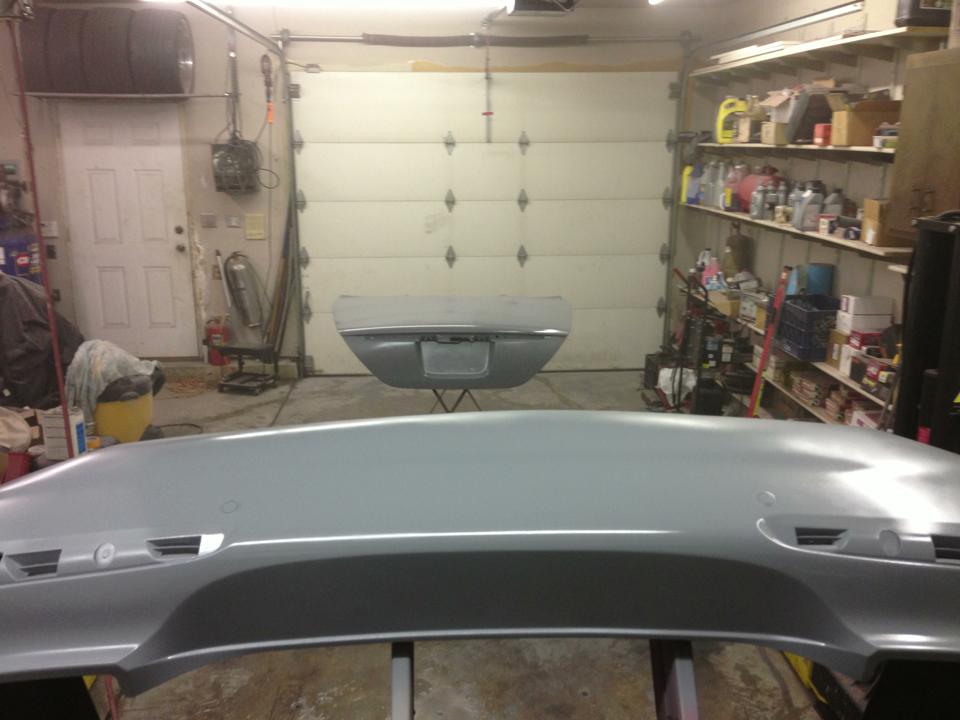

Well guys I sprayed the base real nice and the blends came out good. However after I cleared it I turned on my exhaust fan and what I didn't realize is that the temp outside dropped over 15 degrees (i was working day into night), so the nicely sprayed clear just started to run.
I was able to sand most of it out in the back of the car, but in the front where I was fixing a ding I need to sand/respray the fender as the shapes are too complex and it would be impossible to get all the rusn out.
Good news is the bumper and the trunklid came out nice
Basecoat still wet:
Epoxy sealed bumper and lid:
Foggy conditions
Clear on the lid:
Attached Thumbnails Scooped up an '06 XJ8 for my lady-484715_10151706876358988_286536782_n.jpg   Scooped up an '06 XJ8 for my lady-1069359_10151707392768988_1687837360_n.jpg   Scooped up an '06 XJ8 for my lady-1001496_10151707651508988_1921791086_n.jpg   Scooped up an '06 XJ8 for my lady-1045146_10151707669503988_42978187_n.jpg

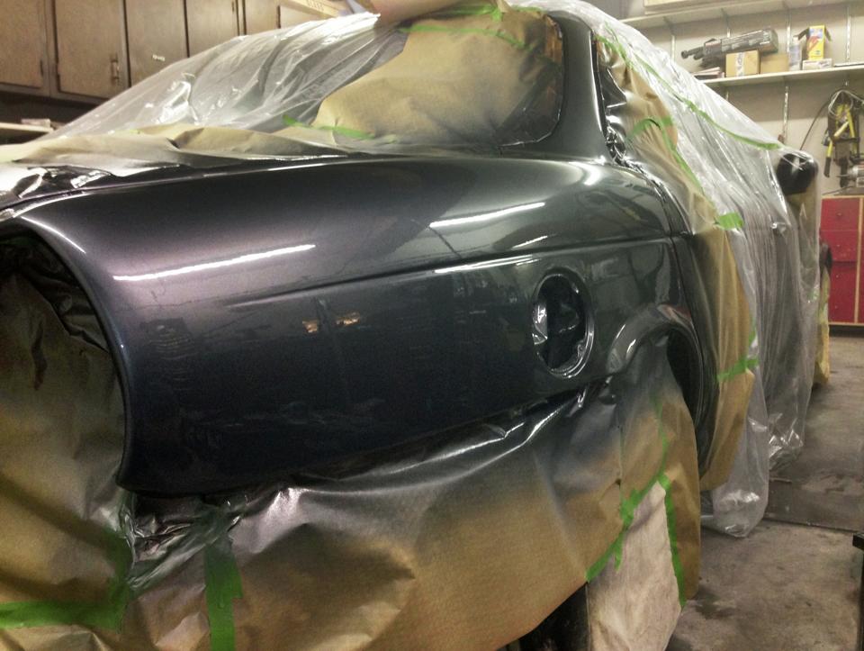

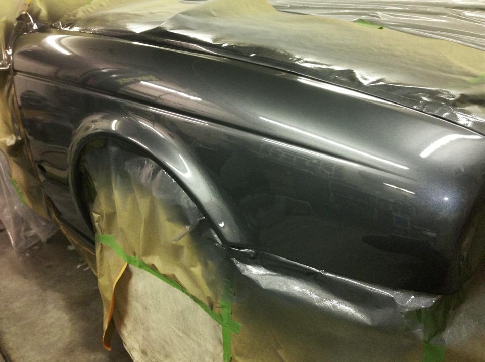

ok. So I gave it a round 2 today. Had to wait a few days to avoid lifting issues.
No runs this time.
Next post will hopefully be the assembled pics.
Also, last week I took possession of a higher milage but very clean '06 XJR that is almost a twin to this one. I plan on selling it but the car is gorgeous.
Attached Thumbnails Scooped up an '06 XJ8 for my lady-969770_10151725434708988_314347537_n.jpg   Scooped up an '06 XJ8 for my lady-969770_10151725434753988_1273488439_n.jpg
