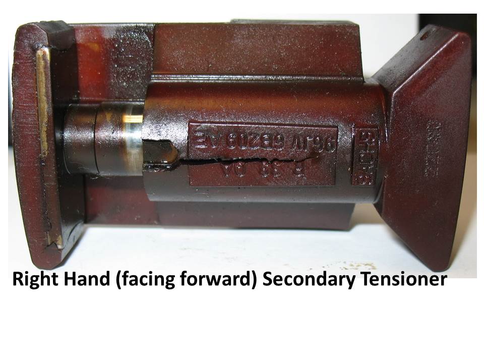

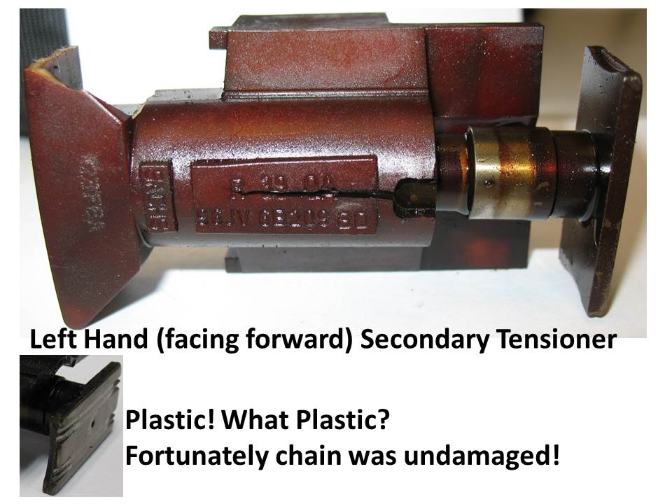

I finally got around to replacing the Secondary Chain Tensioners this weekend, and with 107,000 miles I knew I was on borrowed time, but I did not realize how close I came to a major engine failure!
Both tensioners looked okay when I removed the cam covers, except the left hand tensioner was missing the plastic! Hopefully it ended up in the sump.
When I removed the both tensioners, the damage was on the face you could not see as the pictures below show.
If you are not 100% sure your car has the updated metal tensioners, get them checked as a priority. If you still have the plastic tensioners replace them immediately!
I was one of the lucky ones as there was no indication of imminent failure and it was only because this forum that I even knew of this potential failure.

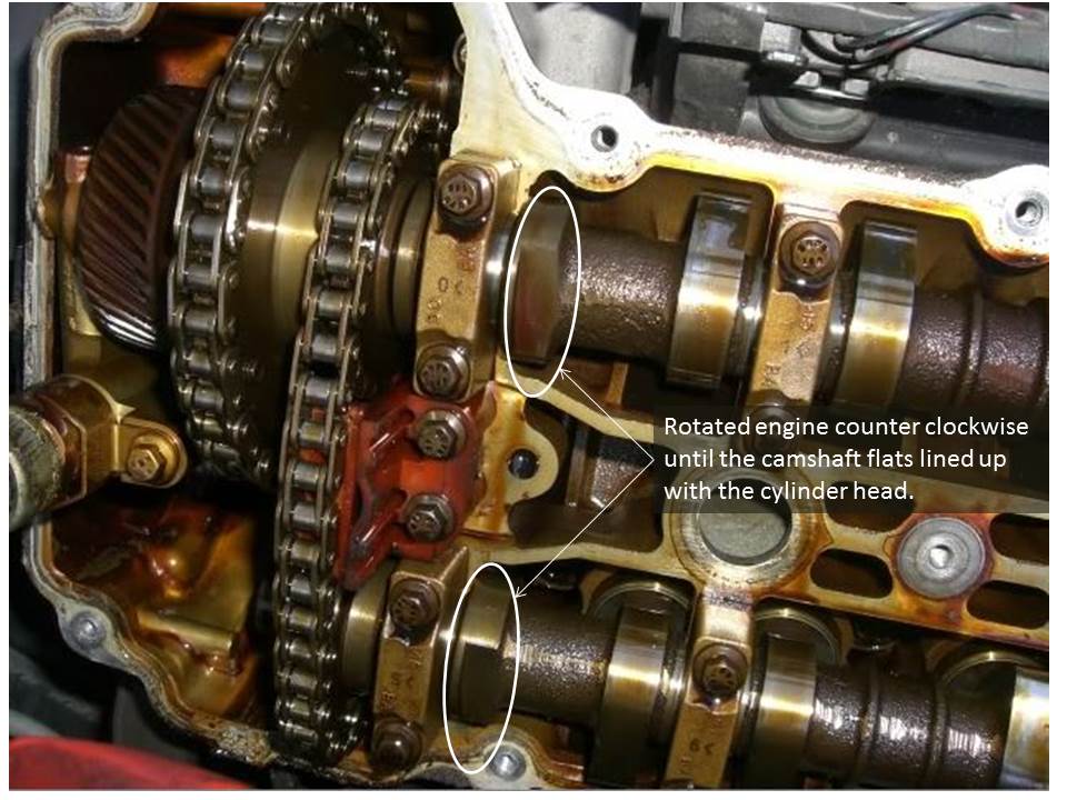

Although I had the tools to lock down the camshafts I could not get the 10mm internal hexagon bolt to loosen. So I used the “Zip Tie” method instead. This turned out to be quite an easy procedure.
I did rotate the engine counter clockwise until the camshaft flats lined up with the cylinder head cam cover mounting face as shown in the picture below. (This is not a picture from my engine), the tensioner on my engine was not holding the chain in tension as shown in this picture.
I did replace the sparkplugs as well as they were the originals.
I bought the tensioners and the shorter bolts on eBay along with the gasket set.
Let me know how your tensioner replacement goes.
All the best to you.
