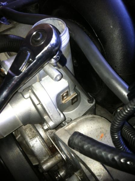

Isn't the manifold in the way of getting the bolt all the way out of the hole? How did you manage to get the bolt out even after getting it loose? I have heard that you can loosen the manifold enough to get the bolt out, but I haven't heard that you can just plain get the bolt out. Am I wrong?
I ran into two problems -- instead of getting a crows foot, I got a closed end ratcheting wrench that was too big to get over the top and behind the bolt, so it was worthless. The second problem was my clumsiness - I broke a connector off the radiator for the pipe from the coolant tank by leaning on it while I was trying to figure out how to get that darn bolt out!
The bolt will come out of the hole after all of the bolts are loose.

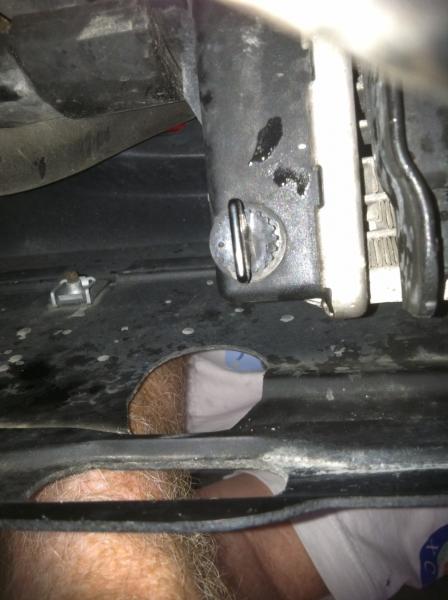

Next the radiator must be drained so the coolant level at the tower will drop below the base. I drained the radiator completely. There is a plastic plug at the lower left of the radiator on the back side. Some sources say to remove the black fascia but his plug can be reached by hand and turned counter-clockwise with your fingers. Some penetrating oil may need to be applied to help remove the plug. The plug is fragile and can be broken if not careful. Collect the coolant in a clean vessel so the fluid can be filtered and reused later.

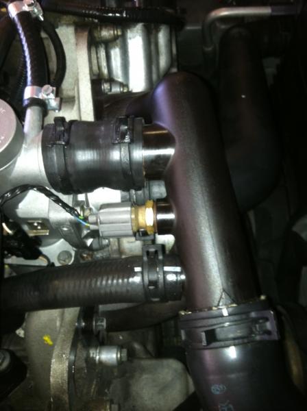

Move the crossover connecting hose back clamp to the middle of the crossover hose. By doing this clamp first you will avoid breaking the crossover pipe. I strongly suggest that this hose (NCA2213AC) be replaced. eBay replacement cost of this item was about $ 10.00 and included shipping.
Next remove the 4 bolts that hold the crossover pipe in place. Various socket extension will need to be used with an 8 mm socket to do this. Carefully pull the crossover pipe away from the block in the two places it bolted in place to break the o-ring seal. Now the only thing holding the crossover pipe in place is the crossover connecting hose. Carefully work the hose off of the existing tower. Once that is removed you can more carefully remove the crossover hose from the crossover pipe and thus avoid damaging the pipe.
With those items removed, you can now remove the left side radiator hose from the thermostat tower bell housing. Again, keep track of all clamps and positions.

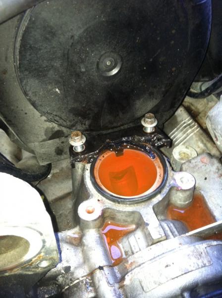

Now the process of removing the thermostat housing can be attacked.

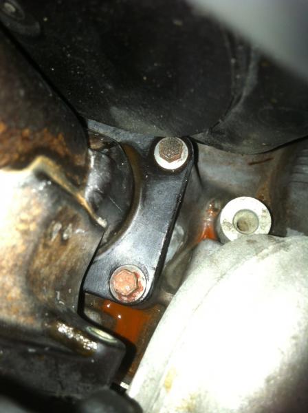

This first photo shows the back passenger's (right side) bolt of the housing base. The head of the bolt in question can be seen towards the top of the photo. You can observe that the black plastic of the intake manifold does seem to be directly above the bolt:

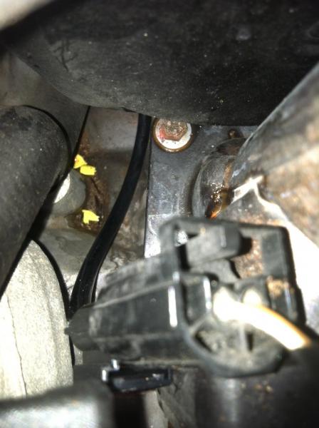

The same can be observed with the back driver's (left side) bolt:
I first removed the front two base plate bolts with an 8 mm socket on a 1/4" socket drive.

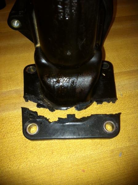

Next, I found that instead of breaking apart the thermostat tower piece by piece with a pair of pliers, that a small chisel and a hammer could be employed and make the job easier in a few ways. This chisel method is not new but I did not see a detailed description in past posts.
I took a chisel that was about 1/2" width at the blade and placed it on the plastic base just forward to one of the back bolts. The chisel blade was thus running from one side of the car to the other. Or, parallel (not perpendicular) to the radiator.
Next, I used the chisel to break about halfway thru the base, went to the other side, did the same, came back, bust the base all the way thru and then went once again to the other side to finish the job. Now the top of the tower could be used as leverage if the crack at the base was not already complete.

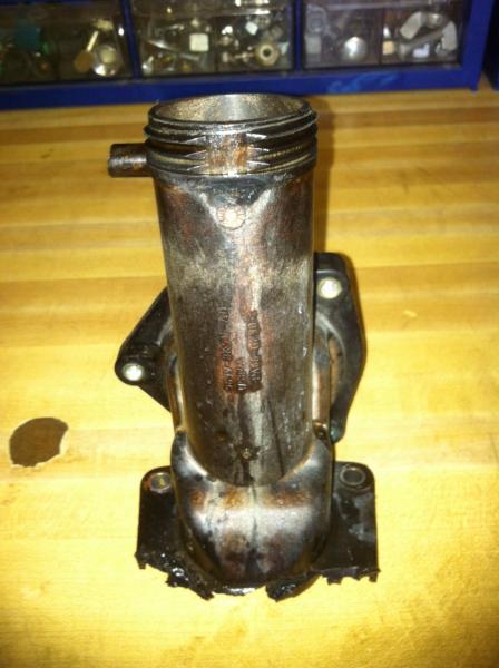

Notice how the thermostat tower base broke in a controlled fashion and thus allowed the tower to be easily removed:
Finally, the back bolts were addressed. I used a regular open end 8 mm wrench and had plenty of room. These back bolts DO top out on the edge of the intake manifold housing BEFORE the bolts completely clear the threads. They actually hit the big circular raised area observed in the photo.
I just keep backing them out with the top of the bolt pushing on the manifold "circle" until the threads cleared. It was not far but one can still get worried that the manifold may crack until one realizes that it only tops out slightly before the threads clear.
Then it was simple to remove the remaining piece of the base along with the screws.
And another photo showing the clean fracture:

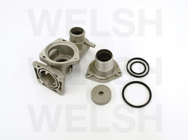

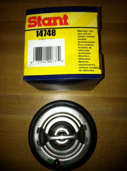

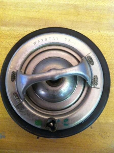

I installed the new thermostat into the bellhousing and bolted it together before installing the tower to the block.
The Stant thermostat is actually made by Waxhall in Great Britian which is the OEM supplier. The cost for this was about $12.00 at regular car parts store (Advance carries Stant). Both the kit and the thermostat came with a rubber gasket (as seen in picture). The one from Stant was a tad thicker but still easily fit in the housing. I went with it to get a better seal.
Remember that the spring points toward the engine and in this position the thermostat will only seat one way because of the pressure equalising valve on the unit will fit into a notch on the housing. You can see this one way ball valve in the photo.
For installation it is important to note that the sealing of the o-rings is what keeps the tower base to engine block and the crossover pipe to engine block from leaking. Thus these surfaces must be cleaned very carefully. The two o-rings on the crossover pipe must be removed and the channels cleaned thoroughly. These two o-rings do not come with the kit. I had to swing by the Jag dealer and pay about $ 7.00 each for these rings - part no. C2C11477010. These rings have nibs on them to keep them in the channel while replacing the pipe. I would not recommend regular o-rings.

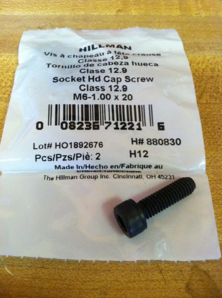

I elected to go with the cap head bolt for the back two bolts on the base. The size is a M6-1.00 X 20. That 20 means 20 mm. The original bolts were 25 mm and that extra 5 mm cause the numerous problems with removal.

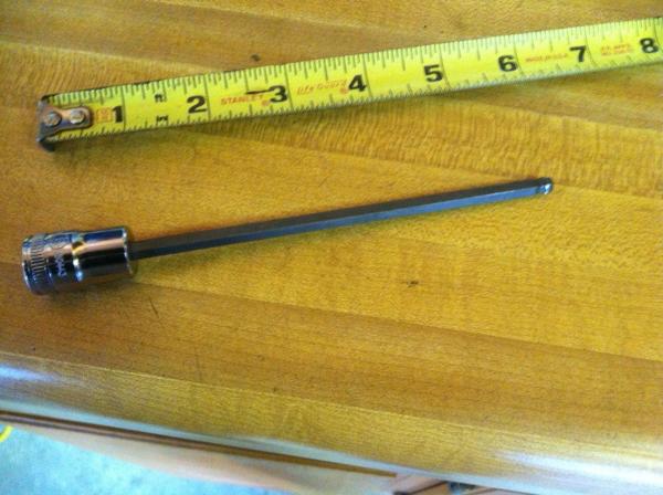

I used a 5 mm ball head drive that had a 6 inch extension to fasten the back bolts.
This next picture shows the angle in which you can drive the cap head bolts.
