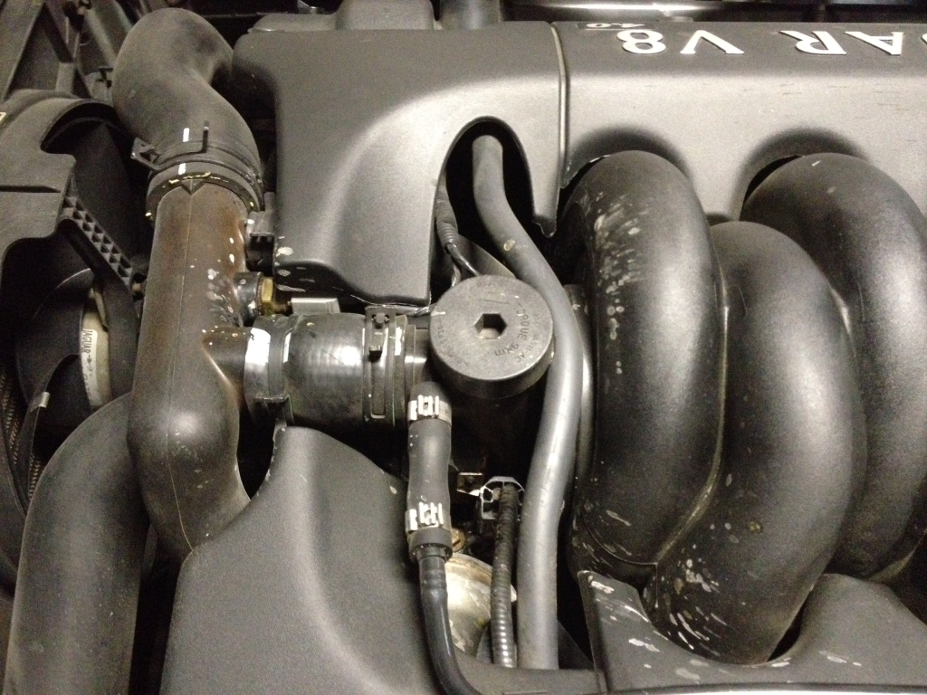

I never got around to fixing my leak but now I've notice some real evidence! I might have multiple leaks, look at this photo. There's some puddling (not pictured) at the base of the thermostat housing, there's some moisture on the horizontal hose the goes past the cap, and lots of splattering. Any comments or suggestions?

May as well replace that short hose as well, looks a little swollen.

You might want to replace the outlet pipe (crossover pipe) while you are at it. Mine developed a slight warp where one of the clamps was. Unfortunately, I don't believe there is an alloy replacement for the plastic. They're about $50 at MotorcarsLtd.

splattering like that is caused by a bad waterpump i believe
