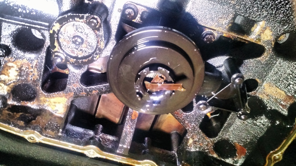

Could drop the oil pan and take a look from the bottom. This way you can also make sure there aren't plastic bits in the oil pump pick up from the chain guides falling apart.

Not to sound dumb, but is taking the oil pan out doable at home?

Yes, as long as you have ramps or jack stands to get it of the ground.
This is what I found in mine-
