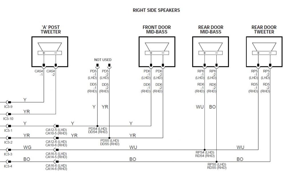

This is the way I understand it when looking at the wiring diagram for the premium stereo. The factory amp does split up and has a crossover built in and sends separate frequencies to the tweeter and woofer in front. But, if you look it over, the rear speakers both get the same signal and I think the rear tweeters have a filter on the speaker itself. I'm not sure how high of quality the crossover system is in the amp. You probably get better quality and the ability to tune it yourself using polk external crossovers.
Jon, what year? From what I can tell, all X308's have the rear door speakers in parallel with the tweeters - NO crossover. The front speakers/tweeters are the same for the standard system, but have the A-pillar tweeters driven by a separate output in the Premium Sound option - I would assume they are crossed over in the amp.
See below for the wiring diagram from 2000 m/y, Premium Sound - Right side... Left side is identical. The 'not used' is the connection for the front tweeter in the standard system.

I'm not very familiar with Polk Audio but have seen/heard their home stereo speakers. I bought into the whole "Bose" speaker hype and got a great employee price through a friend. My Yamaha did a great job of blowing the speakers thanks to a few parties, now they are waiting for me to foot a bill for repair. I will admit the Pioneer speakers I put in my car made it sound much better but I would have preferred to put my JBL's in but they didn't fit as they were 6X9

Now: @thinkpad_master - OK, thank you. That poses some interesting thoughts... @Quadmaniac - I remember you! How are you? Thank you for the diagram. My vehicle is a Jaguar 2000 XJR. @h20boy and @PaulB, thanks for chiming in.
So--if the front speakers are already crossed-over it is unclear to me whether it makes sense at all to use the Polk crossover. I would then be crossing-over and already crossed-over signal... In fact, the Polk crossover takes speaker-level input on one end and has midrange-out and tweeteer-out on the other end. What would I use for the speaker-level input in this case if I wanted to use the Polk crossover? With the Polks installed and wired-up directly to the Jag amp, I am experiencing sibilance and a generally horrible amount of treble (turning the treble control down helps a bit but then middies-up the midrange)--so I am convinced that the way the Jag amp crosses over the signal is just not calibrated correctly for these speakers.

In the auto environment, I would expect a simple capacitor in series with the tweeter would provide a reasonable 'cross over' function for the tweeter - it would block the low frequency components that can cause tweeters to clip... not as esoteric as a quality crossover, but it does the job. If I recall, something like a 10 microfarad, non polarized, electrolytic capacitor will do the job. This is what is typically used in co-axial auto speakers for the tweeter.

FRONT left and FRONT right, not without some surgery, IMO... but low level LEFT and RIGHT are available as analog signals in the AINet cable between the head and the amp or nav box (if you have nav).
I would expect (but is is just supposition) that they did a decent job of separating the high frequency from the low in the amp (Premium Sound system), prior to driving the mid-bass and tweeters

Thanks for your feedback. I didn't know about the Rockford Fosgate unit--wow oh wow. What a beautiful piece of engineering! I have downloaded the manual and will be reviewing it before I decide whether to buy it or whether to give the AudioControl device a try first (I had really wanted simply to properly cross-over the speakers, but now you've got me thinking about equalization...). The one concern I have regarding the 3Sixty unit is that I no longer have a Windows Mobile device. Well--that's not really true--I just no longer use one (I have a decommissioned T-Mobile "Wing" and now use a Blackberry). I would like to know how I can perhaps use a Windows laptop with a Bluetooth USB connector on it in order to communicate with the 3Sixty unit--do you know anything about this? (Ideally, I'd like to see a 3Sixty unit that's got a Wifi interface so that I can connect it up wirelessly to my router and then access it from any machine on my network.) The on-screen equalizer and other controls look spectacular. You made a great choice.
We have tweeters in the A pillars, mids in the door panel; in the rear, the tweeters are in the door-handle assembly and the mids are in the door panel; there is also a single rear-deck dual-cone subwoofer.
I read your other thread... See--that's the whole reason I shudder when I think of some bone-head taking a hacksaw to my door panels.
I know it's not really like that, but to me it is a type of surgery with the installers as the surgeons and my vehicle as the patient. I just don't trust them to put all the parts back where they belong, and I dread the thought that I'm going to have improved sound at the cost of new problems (odd rattles, possibly damage to the interior that the installers will argue already existed; etc.). I thought about doing a bumper-to-bumper video of the whole car--inside and out--and having the installer agree that the video is accurate... But what installer is ever going to agree to such a thing?! I think he would be in his right mind to run for the hills! Still, there can be damage or problems to easily hidden behind door panels or other covers, and I just don't want to worry about what those guys will do. (Did you ever see that scene in "Ferris Bueller's Day Off" in which the valet guys "take good care" of the sports car? That pretty much sums it up.)
I've walked in to a number of car-audio places recently and, maybe I'm just getting way too cynical, but the guys who GENERALLY work there just seem like they don't give a hoot about anything at all--let alone my Jaguar sedan... I'd just rather do the work myself and blame myself if anything goes wrong. Plus, I find it incredibly satisfying to learn something new and to enjoy something I know I did primarily on my own...Regards,
