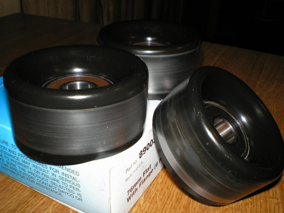

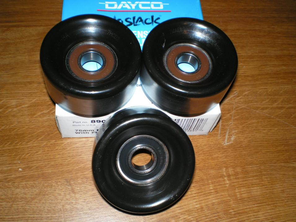

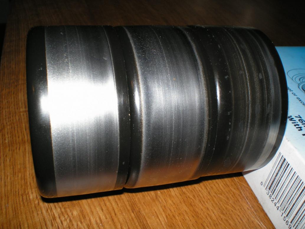

This was such an annoyance for me it about made me sell the car hah. To have such a fancy ride and have it chirp and squeal like a banshee down the road and at idle, that's just sad hah. Anyways.. I got it all straightened out. Check me and Gus's thread here.
https://www.jaguarforums.com/forum/s...t=29520&page=5
It's probably all the pulleys and possibly the belt. I changed my belt 3 times with no change. For my situation it turned out to be my tensioner/idler pulley, and mine were brand new jag parts. I had belt walk and squeal.
I suggest saying "F" the jag pulleys, as they are way overpriced (about $70-100 each), without lips, and like me MIGHT not even be your problem! Then you're stuck with $200 worth of pulleys you don't need.
Get these for replacement of your idler/tensioner pulleys. I seriously doubt you need the whole tensioner assembly, just get two DAYCO $14 pulleys first and try that. For $30 you can't go wrong. They are the same diameter as the jag parts. Put one for idler and one for Tensioner pulley. I bet it stops your squealy bs, it did mine. For $30 you can't go wrong.
DAYCO Part # 89003
http://www.amazon.com/Dayco-89003-Te.../dp/B000C0YR0M
http://www.rockauto.com/dbphp/x,cata...yco_89003.html
Now if you HAVE to have Jaguar Parts hah, I've got 3 VERY lightly used Jaguar METAL Idler Pulleys *can be put in Tensioner spot as well* They're very clean and all under 6k miles of usage.
I will sell you or anyone interested for $20 each, compared to $70-$100 each. Perfect condition, I just don't need them. My problem was belt walk on cold start as you can see I needed something with a lip.
1 has only 100 miles if that,rubber is still over the steel. (tensioner pulley)
2 have about 5k miles on each. Very low mileage
Attached Thumbnails  Squeaking - engine-p2180001.jpg    Squeaking - engine-p2180003.jpg    Squeaking - engine-p2180005.jpg
