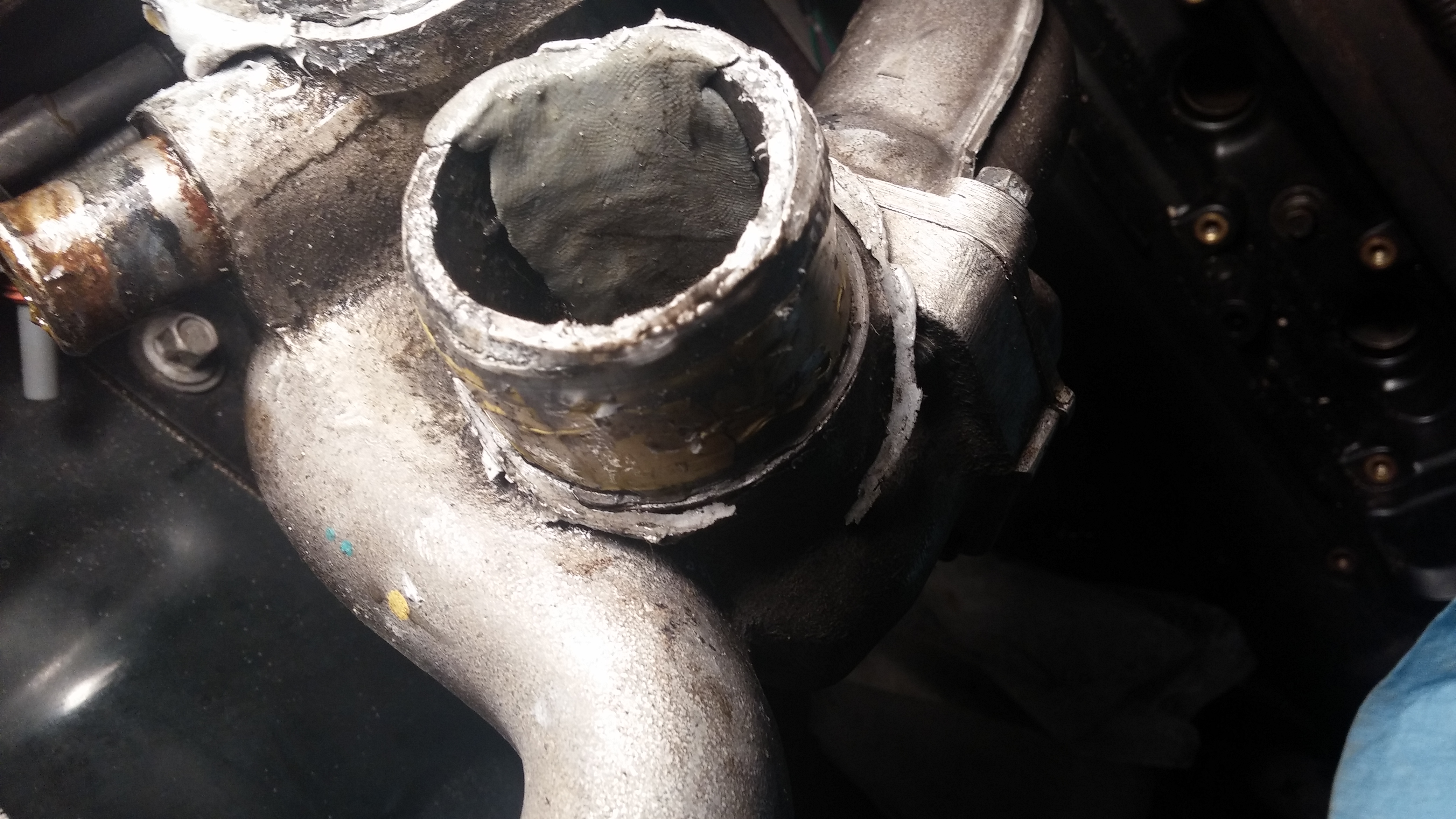

I was planning on starting this tomorrow but had a little free time so I thought I could get a head start. Think I found the contributing factor to the engine overheating and coolant loss (It needed the HG since I bought it so I had nothing to do with this little artistic diy ). I took the thermostat housing off and here is what I found. Apparently Bubba Junior had some JB weld left over from saving hisself some denteest muney by makeen hees owun keerown...

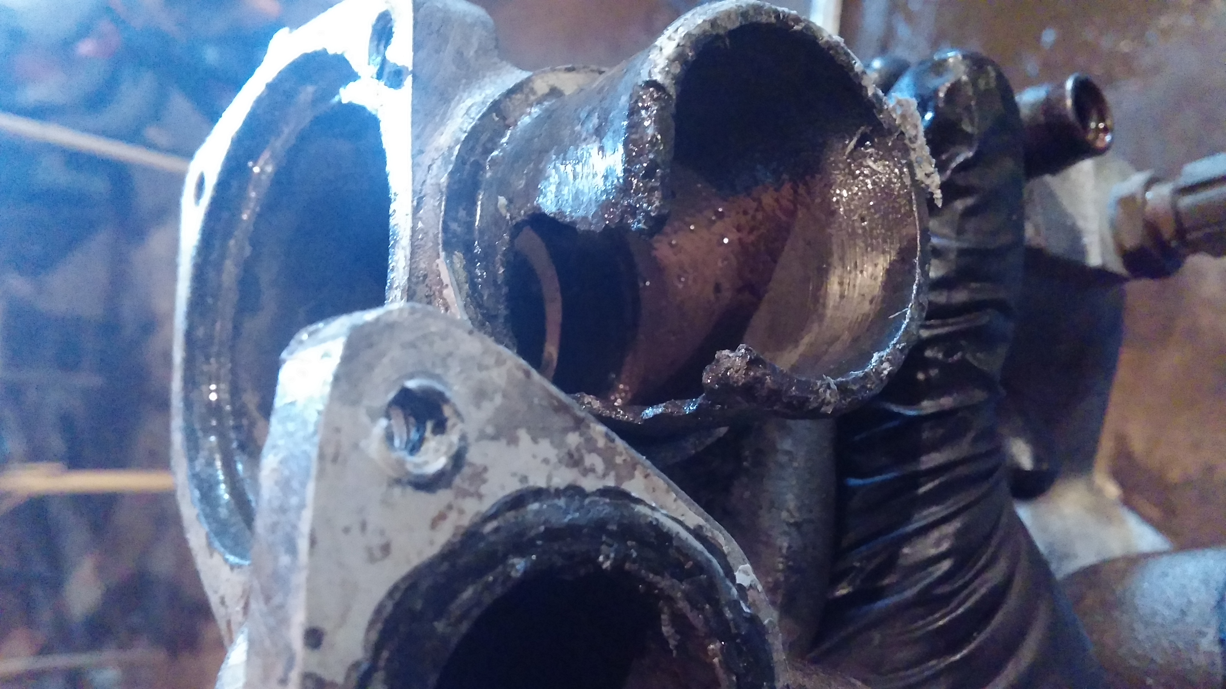

This is how it looks without the jb weld (I'm using JB weld as a generic term for any grey colored epoxy )

Now my first thought was 'why waste all this good epoxy when you could just put a couple of wraps of duct tape and really save yourself some money '. Well except for overheating the engine and blowing the HG and all that.
Hope it didnt have a cracked block or head... Or that he didnt make a jb weld valve or seal a piston with it...
In all rwaitybwhat would have done that? A timing chain breaking or ?

If ever there was a reason for doing a job properly that's it right there. Good luck with the strip down and repair.

The culprit probably spent more on materials and certainly time than a proper replacement, I can't believe someone would risk coolant leaks/overheating = bye bye car in this way.
Some people should be banned from owing Jags...

That much severe corrosion indicates that the coolant had not been changed . . . maybe since new. You are likely to find that everywhere including the coolant passageways inside the block.
