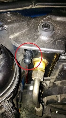

The easiest thing to do is to swop the pipes over on the coolant reservoir, as noted in the document, since that requires no engineering.
If I were faced with this, I'd follow the route RJ237 hinted at and plug the radiator nipple, which is what member sklimii did:
That would allow the 'spare' bleed pipe to be discarded (one part less to fail!).
Last edited by michaelh; Dec 29, 2024 at 11:39 AM. Reason: correct spelling of Steve's forum name
