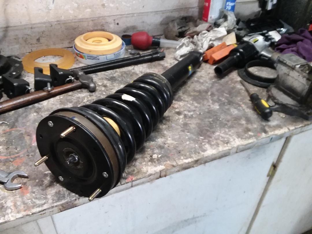

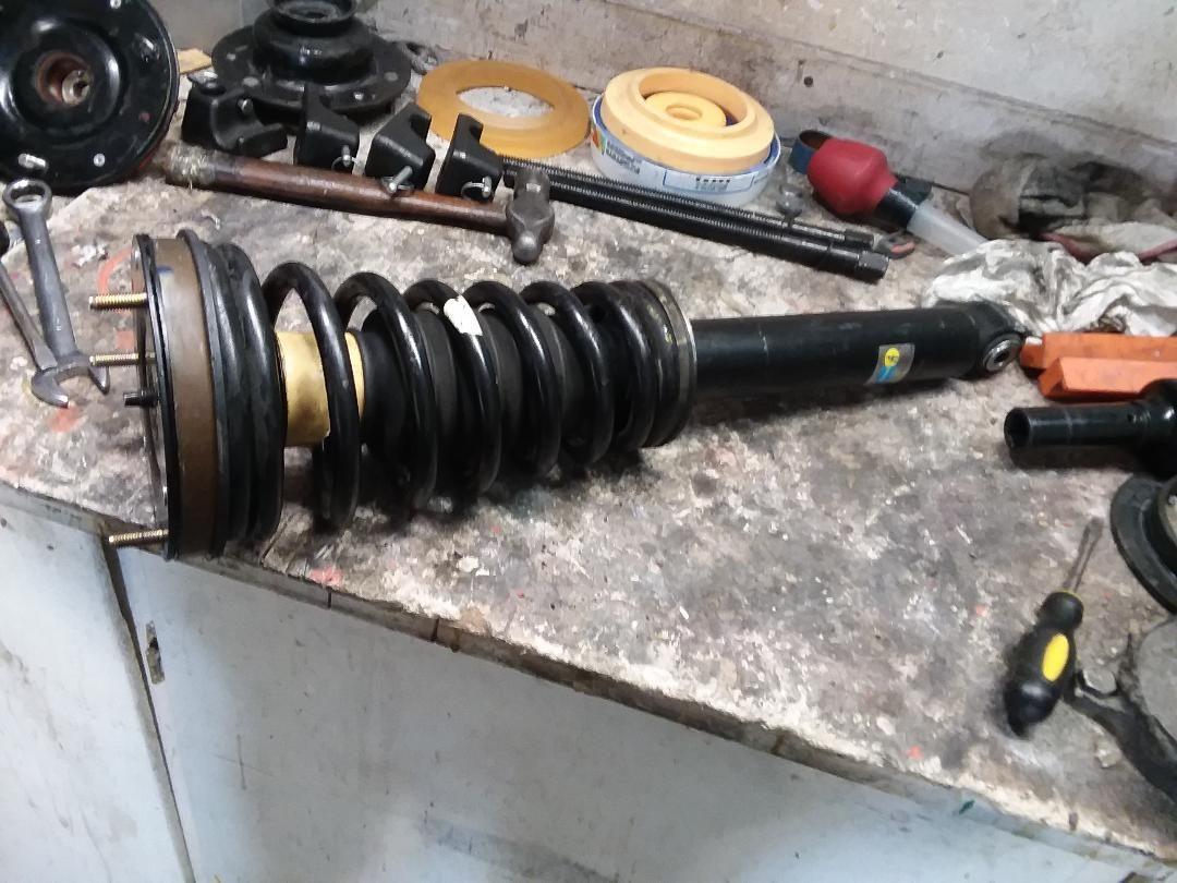

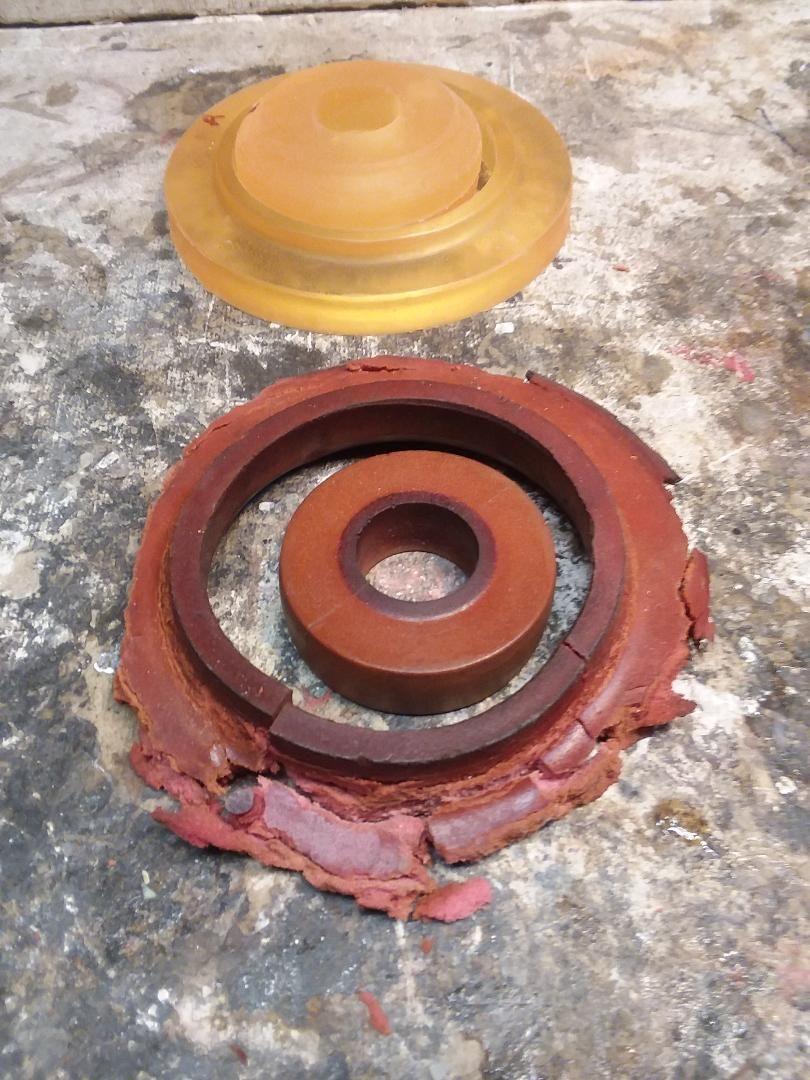

I had installed new URO top shock mounts, only to find after the first pothole that the substance inside the mount had collapsed causing the rattle! So I found the perfect POLYURETHANE FLEXIBLE material and made my own, I now ship these all over the world!
