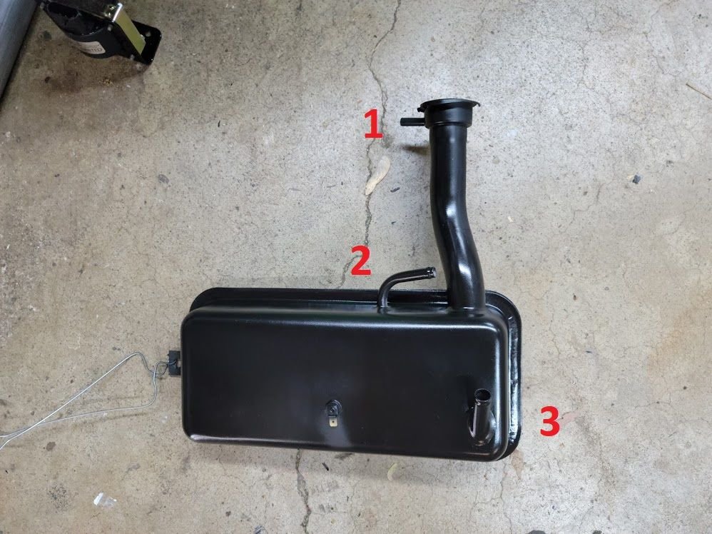

So my radiator header tank CAC8614 is in pretty grubby shape. I cleaned up the outside but the inside is pretty crusty and since I'm replacing the entire cooling system - I need to address it.
In my parts search, CAC8614 is a Special Order item. That means I'm going to have to wait a long time for it.
CCC6725 looks like a suitable replacement, but most of the vendors are selling the Uro version and the reviews on that are terrible. Plus most of them are sold out.
But what if there was a way to do the same thing using aftermarket parts - but better/cheaper? On my header tank, the top hose near the filler neck (#1) goes to the atmospheric catch tank behind the LF tire. The bottom hose (#3) goes to the coolant crossover rail, right on top of the feed to the water pump. The middle hose (#2) goes to the venting arrangement on top of the radiator. The theory being that the water pump draws low pressure on #3 and any air in the system gets purged from the top of the radiator and ends up in the header tank via the higher pressure in #2.
Instead of using the factory header tank, what if I used something like Moroso 63766? It has a bottom fitting that I could put in a adapter and use it as #3. I could put a fitting in the middle port and it could function the same as #2 on the factory tank. There's still a radiator cap and overflow on the top to act the same as #1 on the factory tank.
It's about $120 so it's slightly cheaper than the Uro tank. It's aluminum so it won't rust like the factory tank. The only downsides I see are that the ports are on the wrong side (which is easy enough to fix) , it looks to have less capacity than the factory tank, and there's no provision for the coolant temp probe (but I could weld in a bung for that).
What am I missing? Does the factory header tank do (or not do?) something I'm unaware of? Why is this a bad idea?

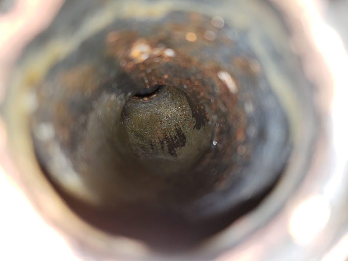

Instructions unclear - am I supposed to drink the vinegar and flush the tank with beer?
Just kidding. Here's a before shot of the inside of the neck of the tank:

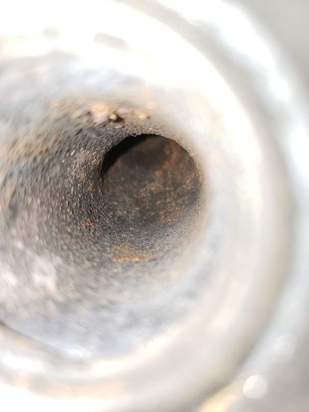

And here it is after I plugged the hose fittings and let it sit with vinegar for about 7 hours:
I flushed it about 25 times this morning until all the debris stopped coming out. It looks like most of it was paint but there was some rust scale that came out as well. I'm going to do another vinegar soak today and see if I can get it any cleaner.

After a total of 24 hours of soaking in vinegar, this is what it looks like now:
There is still rust, but less than there was before. The concerning part was that I could never flush all the debris, which mostly consisted of paint, out of the inside of the tank. There were some rather large pieces that would have caused issues.
So I went another direction. Moss Europe sells CCC6725 which is an aluminum version of the coolant tank. It wasn't cheap, but I felt like it was probably the best option for the situation. Do it once, do it right, do it all. Thanks to all for the suggestions/ideas.
