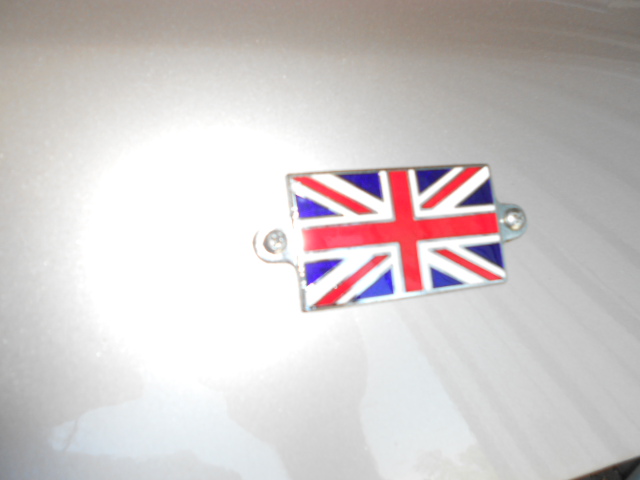

my fix for rusty tanks!
nice plastic Nascar fuel tank, stainless internals pump, aluminum 1"2 lines, Aeroquip stainless flex lines and fittings, Extruded aluminum fuel rails, 12 new stainless injectors!
only thing on my trunk/boot was Union Jack diecast porcelian.
Attached Thumbnails 90 Convertible Rusty Fuel Tank and Sump Tank-trunk-xjs-fuel-system-union-jack-001.jpg   90 Convertible Rusty Fuel Tank and Sump Tank-dscn8787.jpg   90 Convertible Rusty Fuel Tank and Sump Tank-trunk-xjs-fuel-system-union-jack-003.jpg
