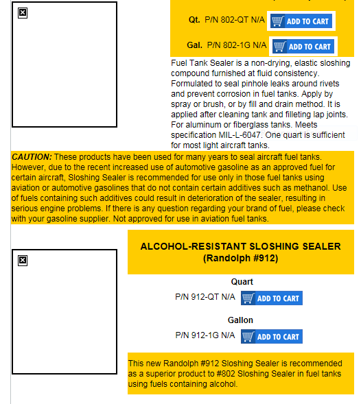

Smile
Could have been this. Or some from Wisconsin have been known to use cheese.
Ah yes, I'd be willing to bet that's the stuff that was put into both tanks, Wisconsin cheese notwithstanding!
