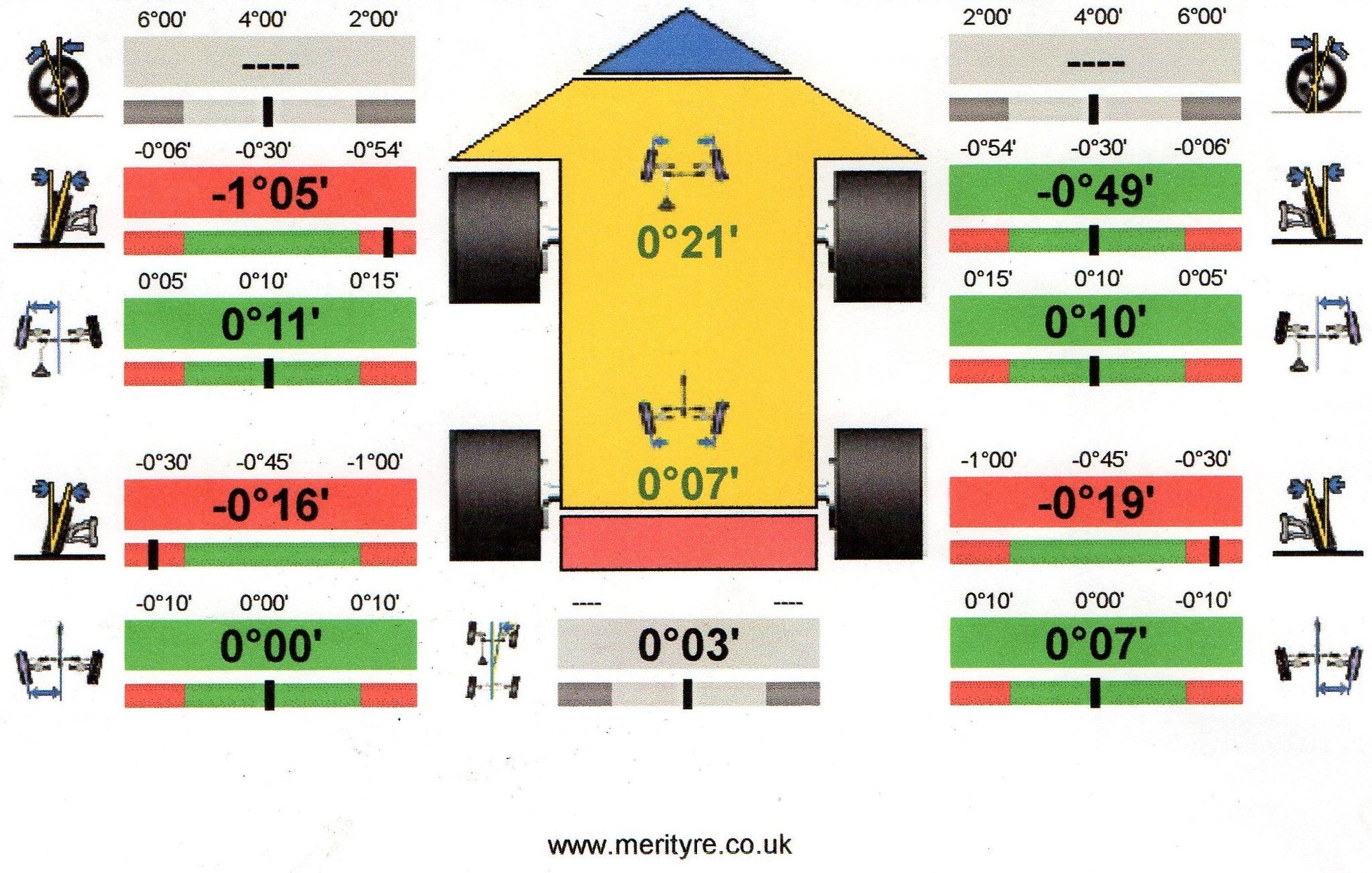

Rear wheel camber shims. How much in degree's do individual shims change the settings? Pre facelift inboard brake car.

According to the ROM he shims are .020" thick and each shim will give a ¼º change

cheers Doug so looking at this I need 1 on 1 side and 2 on other, would you say. I did the front a couple of years ago

Negative is good, you have just a tiny amount. I would take out at least 3 each side and the handling, particularly in the wet, will be vastly improved. Anything up to 0.75 of a degree is good, I have found.
actually Greg this was done after I took all shims out to fit bigger tyres to stop them rubbing the arch when car was loaded

Technically the rear camber is out of spec, but unless you drive the car pretty darn hard, you will not notice the difference. Under hard cornering, you will have slightly more oversteer than you would if camber were more negative. Tire wear will not be an issue. Adding any shims to the rear will make it more positive, that is not what you want. If I were to change anything, it would be the camber on the LF.

So my Left Rear Camber is at -0.2 and my Right Rear Camber is at -0.3
I have lost some control in the rain, under light conditions, when making a sharp turn, at low speed. I've always blamed the tires. Do you think the camber should be adjusted?

No, the camber is fine; if anything take a shim out each side to make it more negative, which will improve rear grip on corners. The tyres' grip in rain is the tyres, not the camber.
