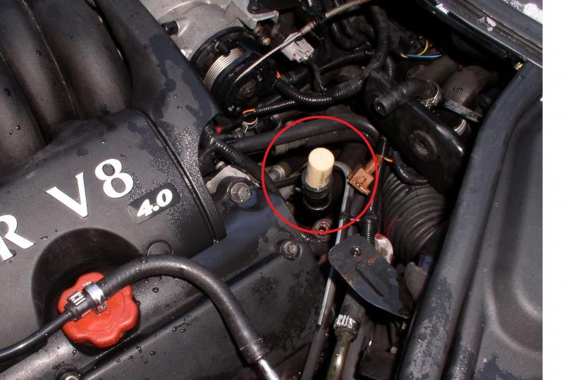

Have a bottle of wine the night before you remove the Expansion Tank. Standard size cork is a perfect plug for the bottom water hose (circled in RED):
I should have checked the forum last night!

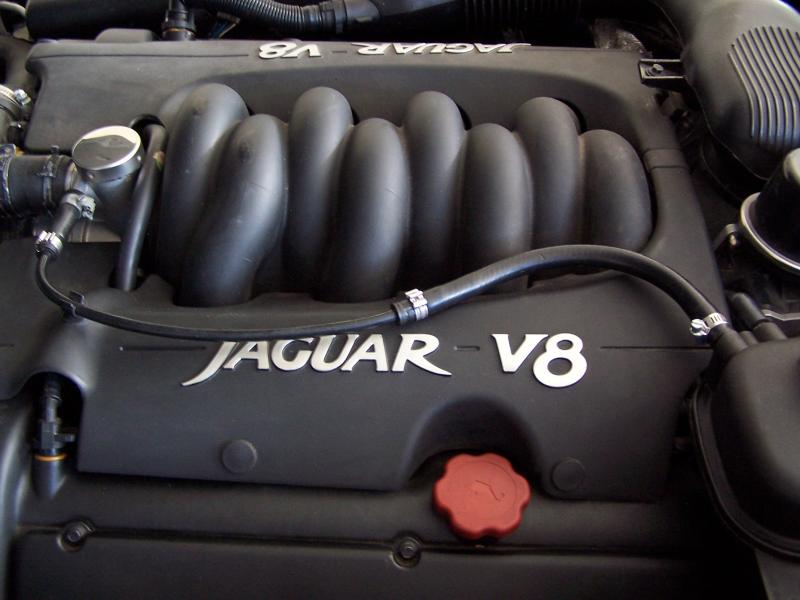

Thanks for all the great replies. Found a "Martini" cork in house so I used it and I clamped off the hose with a small Visegrip pliers.
I discovered I had an expansion tank from a 98 MY with a plugged rear fitting. This is the subject of TSB 303-15.
I removed the expansion tank, blocked all the outlets and filled it with Prestone Super Radiator Cleaner. I let it set for about 45 minutes. Dumped it out and flushed the tank with water till it ran clear. Looked at the float with an inspection camera and it was very clean compared to before cleaning.
Since the rear bleed fitting was blocked on the expansion tank, I removed the bleed line and blocked the radiator outlet with a 3/8" vacuum cap. I double clamped it.
Attached Thumbnails Expansion tank clean out-blocked-air-bleed-expansion-tank.jpg   Expansion tank clean out-blocked-air-bleed-rad.jpg   Expansion tank clean out-one-air-bleed.jpg
