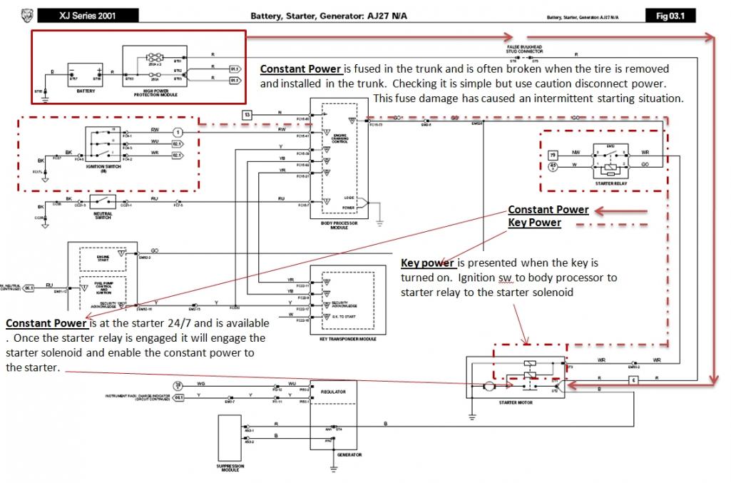

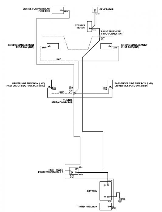

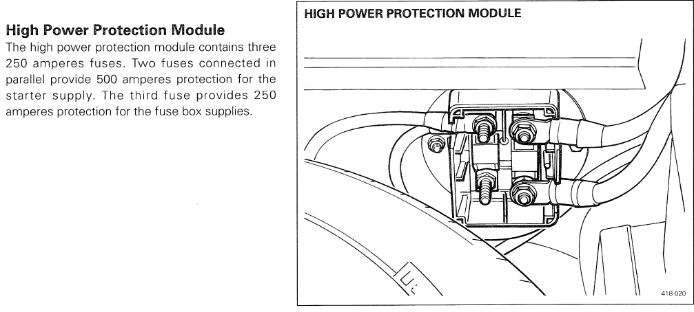

So where do you start? Many of the intermittent starting problems are related to electrical component issues and a few related to fuel. First you need to verify that you have a constant fuel pressure to the engine. Your car is an “R” and that means you have 2 fuel pumps. If you have pressure then when the car does not start move the shifter from “P” to “N” and see if you eliminate the problem. If this is not the problem then you need to check your starter relay and then the electrical feed to the engine compartment. That fuse relay / fuse box feeds the engine components. When doing this use caution, you do not want to short the system out. I am attaching a few diagrams to help on the electrical.
