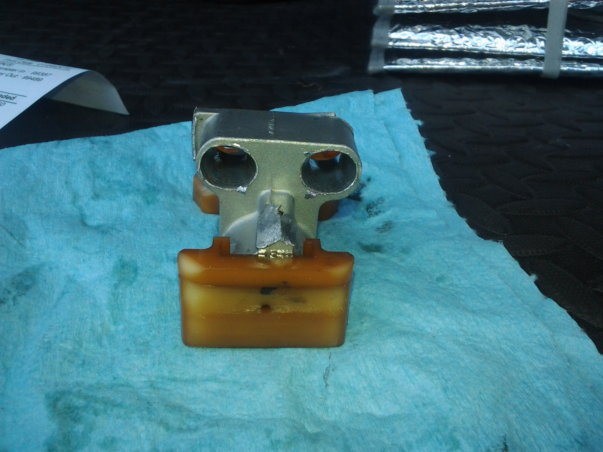

Car is back have attached the photos of the secondary tensioner that was the main problem. The sliders showed some wear as did the original primary tensioners. A complete timing kit was installed. So everything is now new.

What happened to those mounting holes?? Is it me or did somebody drill wider holes into there to remove the tensioners? I do see the wear on the slides though.

Your right Addicted2boost, those tensioners have been modified, but I think to fit stripped threads and thus fit larger bolts. You can see the thread marks on the first pic where they didn't drill it out large enough. Mr Teaser is correct to never go to those guys to fix his baby.
Hopefully the mechanics MrTeaser used and said fixed the problem, did so by fixing the oversized holes. There are only 2 ways I know to fix that without replacing the heads and one is to weld it, redrill it and tap it....the other is a threaded block insert.

WOW. Any wrench that did such crap work would NEVER touch even my car keys again, let alone anything that required more than 2 brain cells firing in unison to figure out.
Glad to hear that, regardless of being a ways from home, it's all good.
Thread inserts (helicoils or timeserts) are a time-tested repair. If they're good enough for cylinder base studs on aircraft engines (where the implications of failure are a bit more serious), then I'm thinking if they did have to drill, tap, and go the insert route, you'll be ok for a long time to come (if that's what they had to do...).
That's always the problem with aluminium components...especially if the threads are fine pitch and shallow...easy to fail by pulling out.
