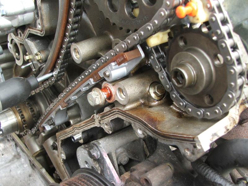

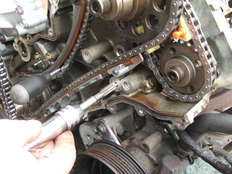

do it like this....
Tap out a similar size metric, then use a short bolt with a copper sealing washer and plenty of threadlock.
Attached Thumbnails Strange valve clearance problem.-dscf5561.jpg   Strange valve clearance problem.-dscf5562.jpg

Steve, don't forget to use a thin screwdriver with a blob of grease to pickup the swarf after tapping out the hole , you don't want bits of metal in the oil system. I guess you used a VVT head!

Thanks Sean! Yes, as magnet is not "usable" for gathering the aluminium bits, I will use grease.
As I wrote earlier I got a VVT head, but I forgot about the VVT oil gallery. Thats a shame, so I will became a practiced front cover taker.
