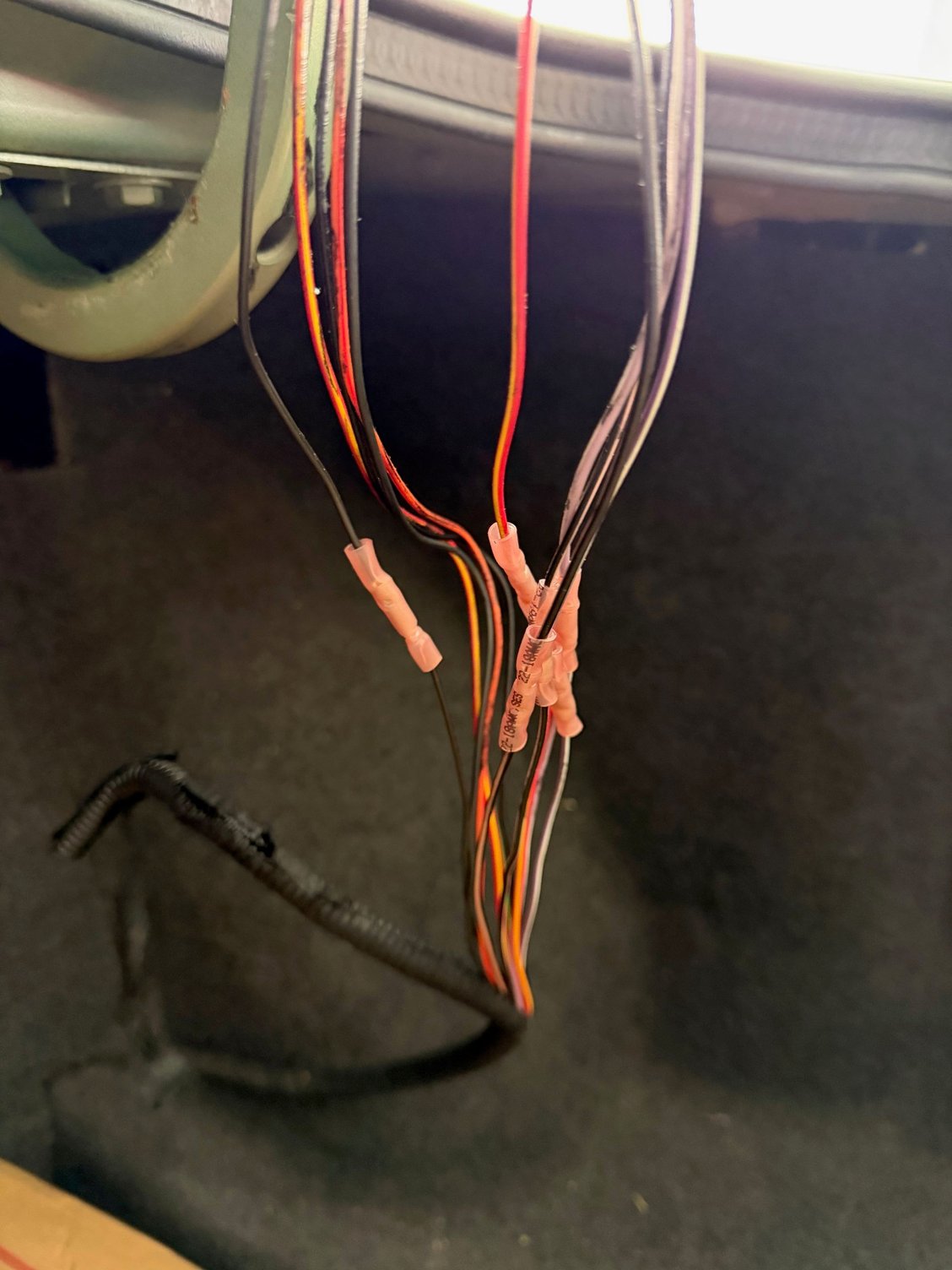

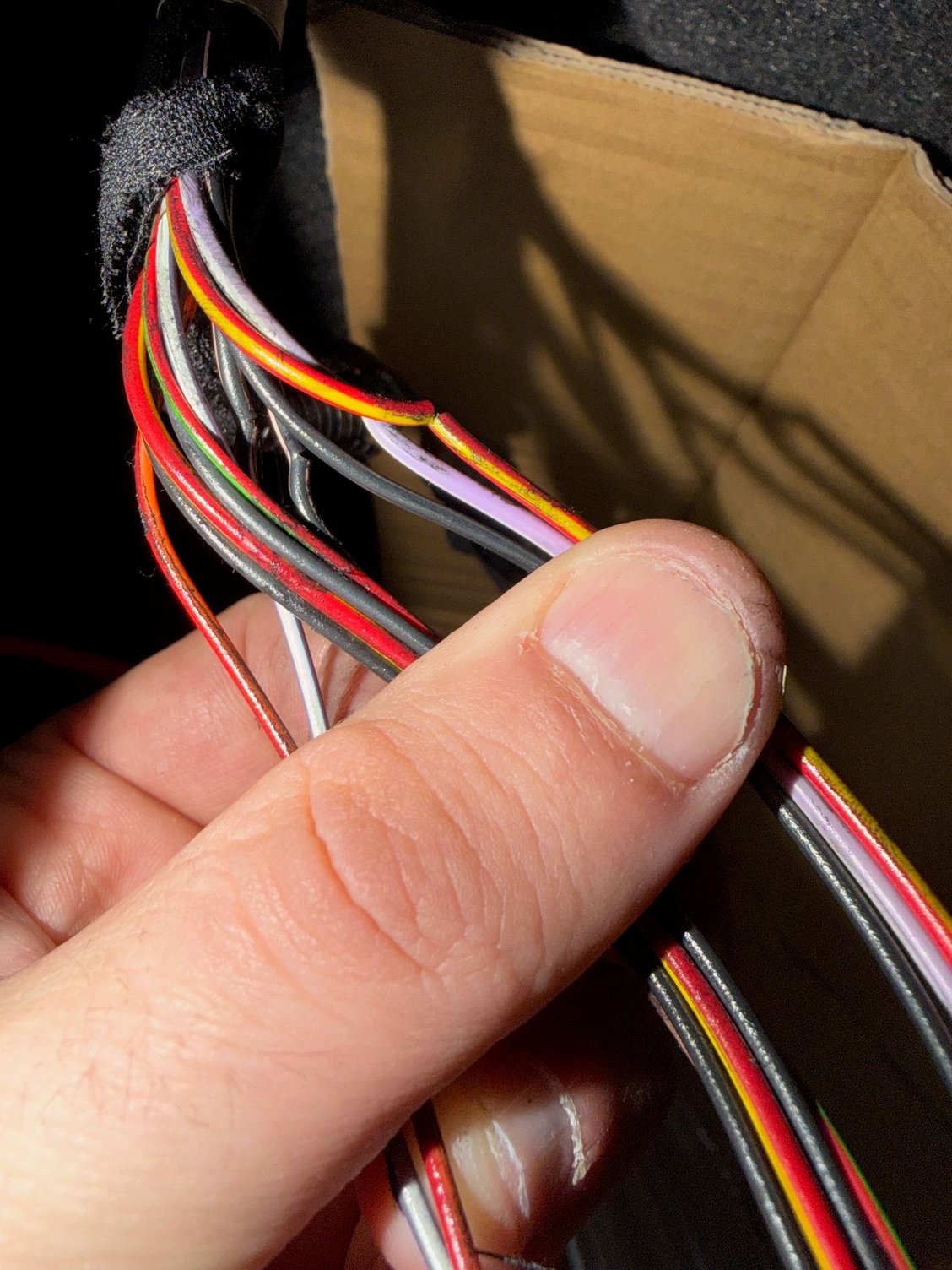

So I managed to find a few broken connections at the boot pinch point and used butt connectors to fix them, but no luck. Did I do something wrong in my butt connectors or is there somewhere else to look from here? Lights in trunk, as well as the lights for the license plate don't work, but the trunk button itself does make a nose when I click it indicating the car is in valet mode and the button won't open the trunk. Is the trunk button also on that wire harness indicating that there is electricity flowing through the wires? A little disappointed my butt connectors didn't get the trunk lights back on to kick it out of valet mode.

Relay # 5 in the trunk fuse box controls the Number Plate Lamp through fuses F19 (5A) and F21 (5A). There's also a diode in line though I don't know its location. You might short pins 1 & 5 of relay #5 and see if the plate lights up. Put a paper clip in the relay slot and turn the car on. If not, perhaps one of wires is still broken but not visible in the trunk lid hinge bundle.
Disclaimer: I'm not a real Jaguar mechanic but have managed to bumble my way into keeping some of them working!
