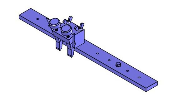

To replace any shims without removing the camshafts, you need a special tool:
It is tool No. 303-540 and currently seems only available from Bosch Automotive Service Solutions (https://jlrequipment.service-solutio...px?SKU=303-540). I got it from them, made in Hungary, by the way.
You will also need a set of feeler gauges in smallest increments you can find. I bought the shims that I did not have (at the time of heads rebuild) from SNG Barratt.

I hope the ticking is due to some incorrect valve shim clearances - I will know when I decide to have a go with my special tool (I now have all shim sizes ready, in 0.015 mm increments). However, it may be a kind of "mysterious knock" (to do with the engine design?) as others have also reported it and I have not seen a solution posted by anyone. I interpret the fact that the factory went from initial 0.02 mm shim increments to 0.015 mm increments (for the engine, I presume, very sensitive to valve clearances, causing ticking if not perfect) was due to difficulty setting the valve gaps accurately so that they don't produce ticking thus even finer increments of the shims were necessary.
To replace valve shims, you either (after reading the existing gaps):
Remove the camshaft(s) - done in-situ but quite a bit of work, or
Use the special tool No. 303-540 - requires only removal of the cam covers

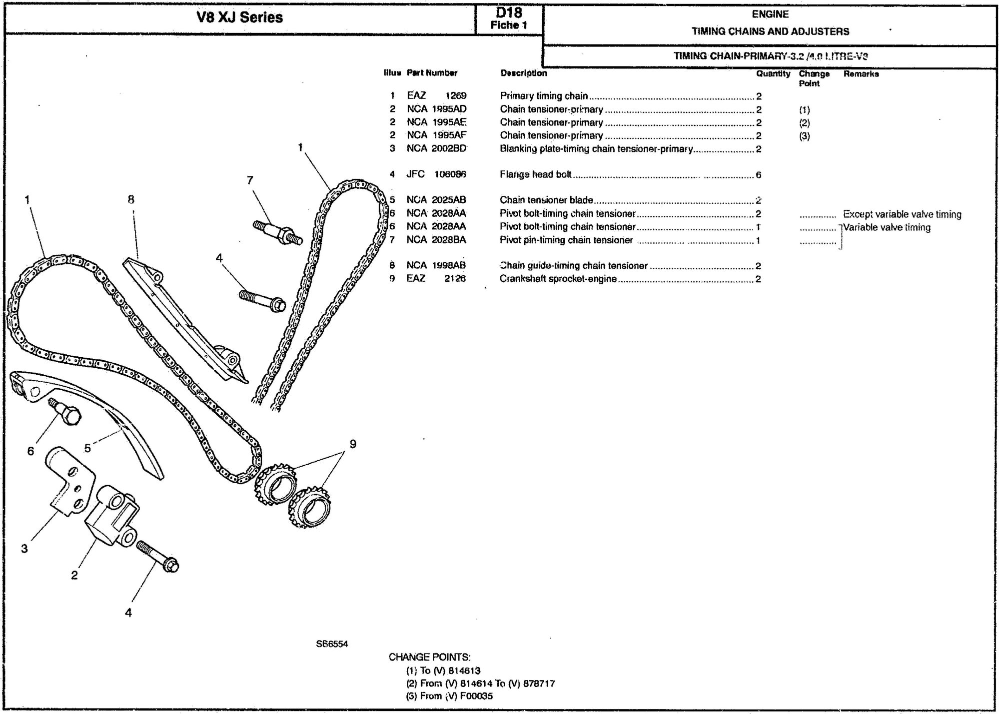

However last night I was scrolling through the forums and just reading stuff and I saw one guy said that the crankshaft sprockets had to be offset a tooth and I didn’t know that, I believe I put them back correctly but if I didn’t it would be pretty obvious right? Also my primary chains were really tight like I couldn’t even fit a shim in between the guide & tensioner.

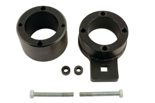

also I’ve been meaning to post my trick to getting the crankshaft pulley bolt off, what I did was take a very large pliers (20.25”) and I placed that on the two raised sections of the pulley between the regular belt and supercharger belt and with two people we could take that bolt out pretty easily.

Don't use that method again. The pulley is not solid but it has a rubber segment between its centre and outer parts as it is also a harmonic balancer. Holding the outer part of the pulley may shear the rubber segment (a new pulley is USD 1,800). You may have been lucky as it seems that your centre bolt was previously not tightened to its full torque of 375 NM.
You may remove the bolt using a powerful impact gun (don't hold the crankshaft using the locking pin for setting the camshaft timing in any case) but to torque the bolt you need this tool which holds the centre part of the pulley:
This is for SC engine pulleys. For NA engines, the large spacer is not needed.

The crankshaft sprocket is one-piece, so the offset is already there. You didn't mess up anything.

The crankshaft sprockets are two separate parts but, as they are the same part number, they can be installed in a way that their teeth are aligned. If the teeth are aligned when installed, one sprocket needs to be flipped-over in order to have the teeth offset as required.
