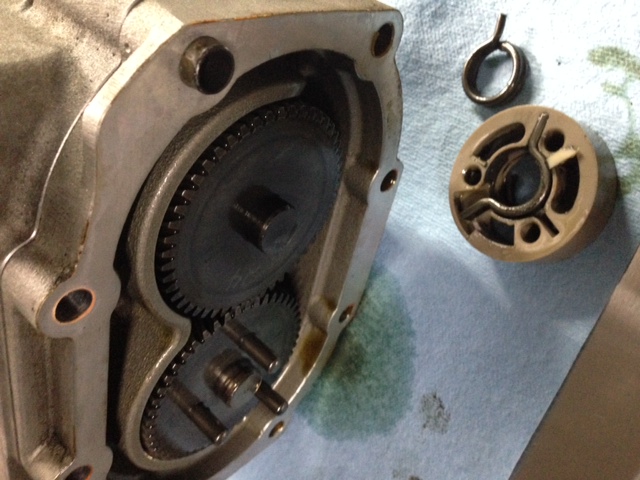

Old Nov 26, 2013 | 04:13 PM
  #30
phemes's Avatar
Joined: Nov 2013
Posts: 20
Likes: 8
From: Kansas
Default Same problem
Here is what I found when I took mine apart, there was about 30 degrees of backlash on the pulley when I took the belt off and noise was only heard on engine over-run after a throttle blip.Supercharger problem?-broken_coupler.jpg
