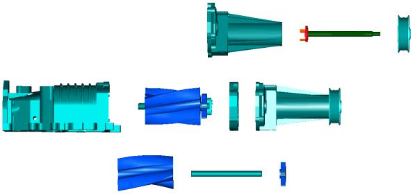

Yep, drop the SC belt off to confirm - the engine will run without issues with the SC disconnected, if the noise isn't there, you can assume its the charger - your model year hopefully means your engine has metal tensioners, so we could rule out timing parts making the noise, possibly....
Is the noise more prevalent when it comes off revs? If so you'll need one of these fitting....it's the one thing that can cause this kind of noise. The coupler.

Originally Posted by Vector
Sean,
Where does that coupler install in the SC?
Vector
On the front of the top rotor. If you have to ask, leave it to the experts.

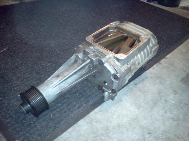

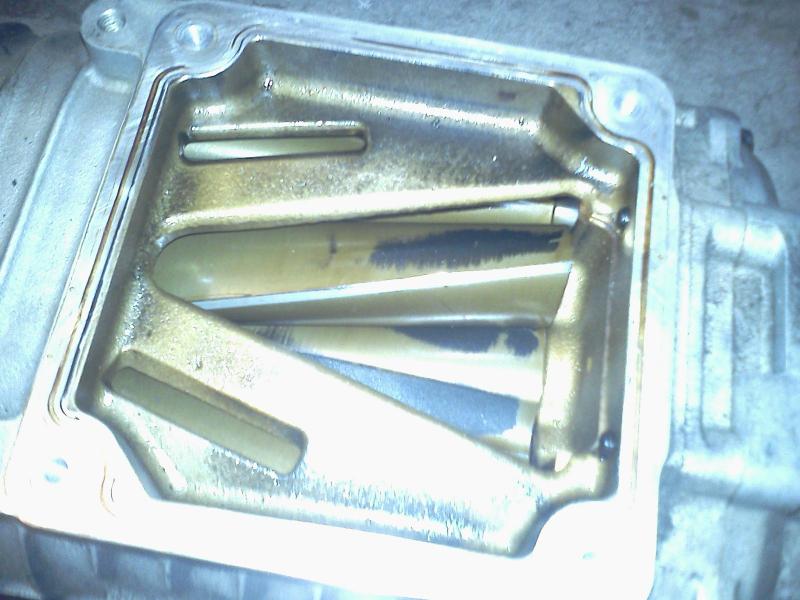

this whole operation was a pain, but it's out. it's interesting how there are coolant lines into the throttle body and 3 coolant hoses under the supercharger, wiring clips everywhere, and many vacuum lines.
SC doesn't seem to be in too bad of shape
