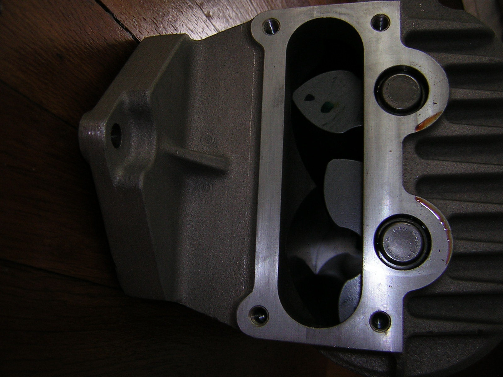

Hope I attached it correctly, this is pic of the new one, G model. Old one still on car, may have pic of engine but I am sure your already well familiar. I'm looking for one anyway.

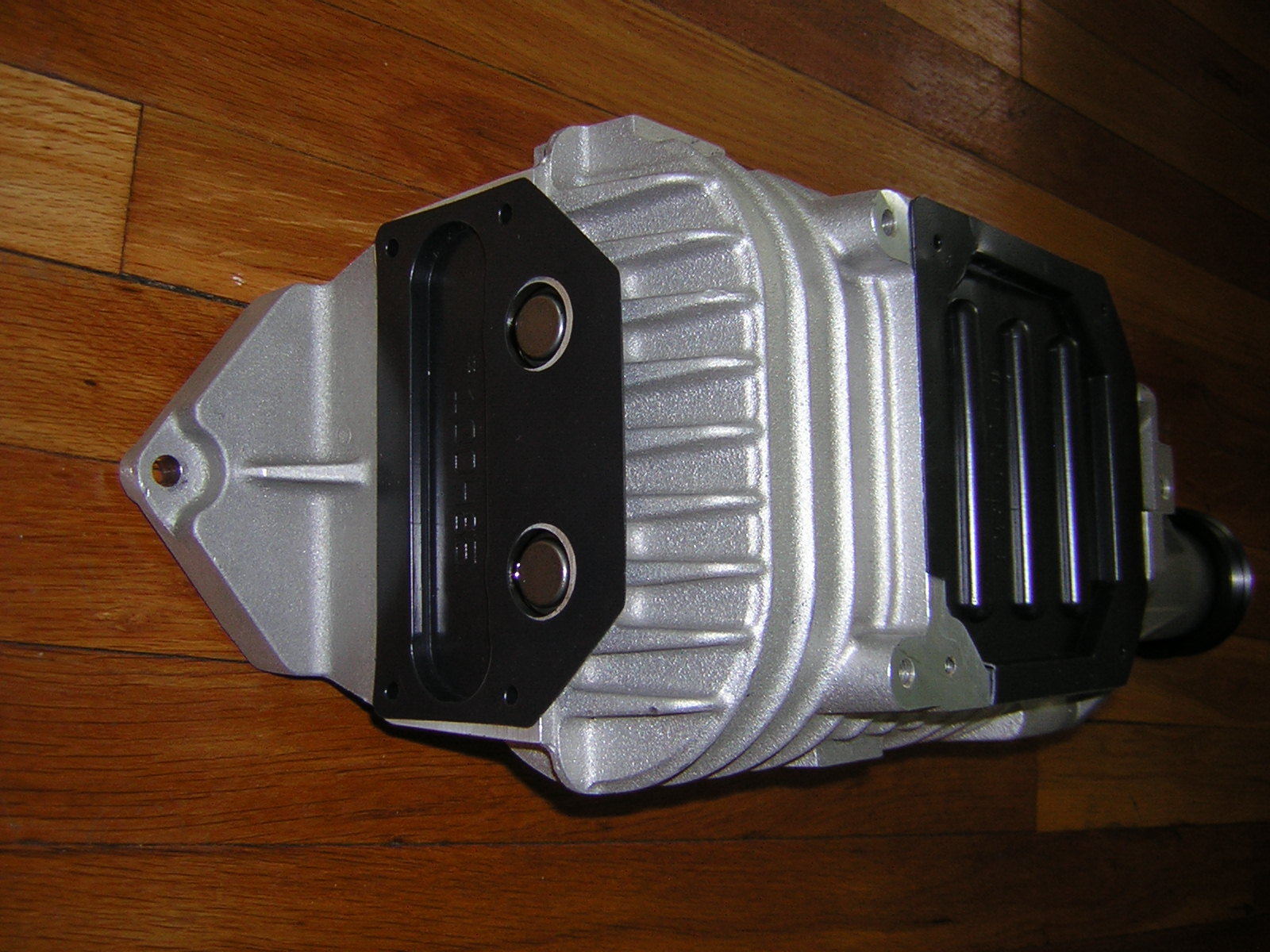

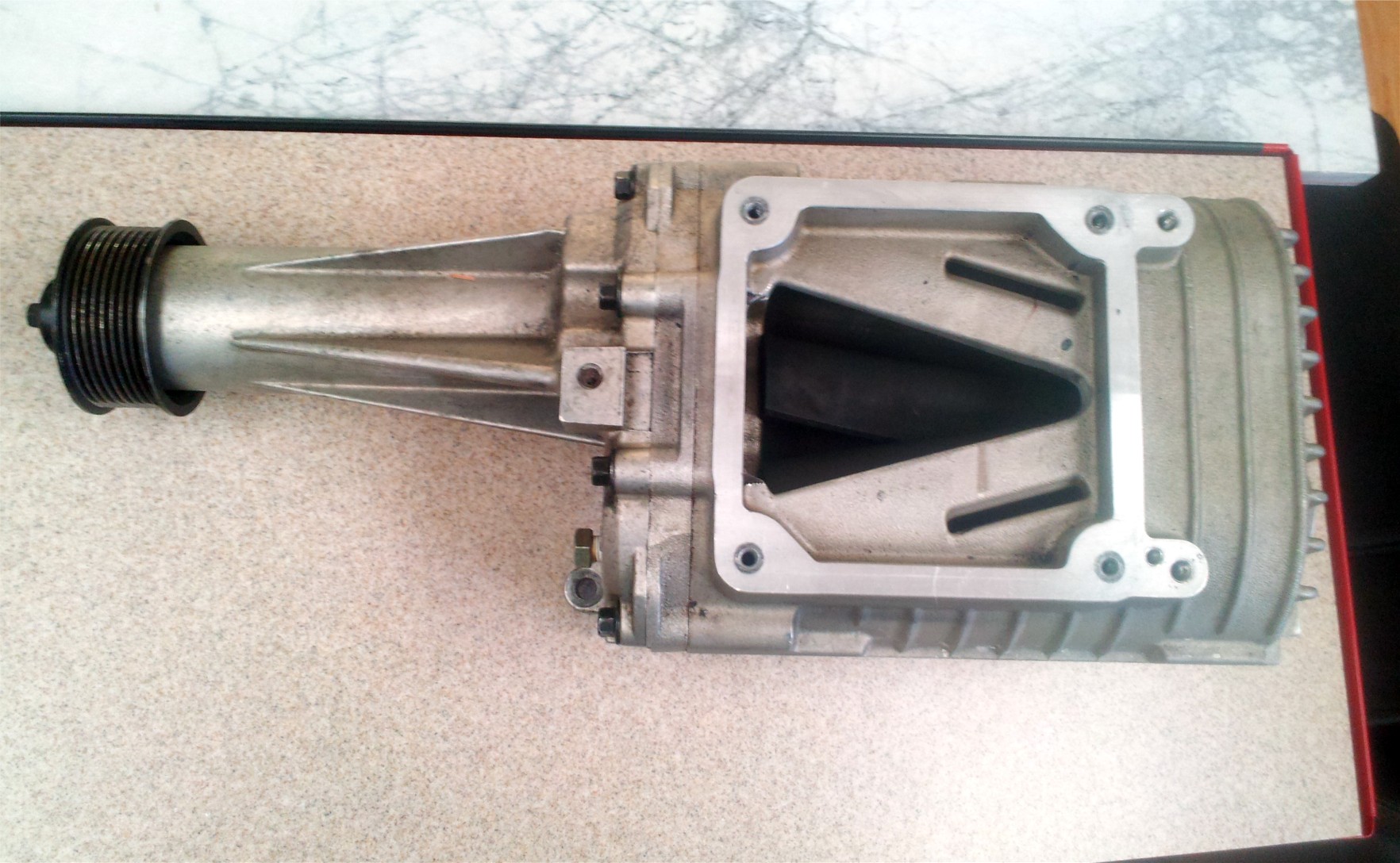

Can you take a photo of the rear opening?
The top left photo is to show the top opening which is the same on the different generations.
The photo to the right is of a 5th gen Eaton M112, which works very well on the earlier 99-2003 cars but you would need to dremel two small cuts for the elbow to mount, and get the updated gasket.
The bottom photo is the regular gen 3 Eaton M112 which is what your car came with and bolts right in.
All of these will work on your 1999, but the 5th gen eaton (which is better, more efficient, less boost drop off at higher RPM, and slightly less heat) requires about 15 minutes of time with a dremel to make fit perfectly. You can see the two cutouts that would be needed in this post:https://www.jaguarforums.com/forum/j...-inside-99281/

Yes, that is a direct replacement, no modification needed. Just make sure it has oil in the front snout before installing it and you are good to go
